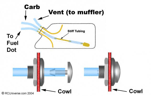

I bought a dubro kwik fuel valve system. I still do not quite understand how it works. If someone could provide a quick drawing and or explanation it would be appreciated.
Also, how reliable are these systems? Can you defuel with the Dubro system?
I''ve heard stories concerning stuck plungers, etc. I''ve got a lot tied up in plane and if it''s going to be another thing that goes wrong I might just skip it.
I also heard using a "fuel dot" instead, however, I don''t know what a fuel dot is.

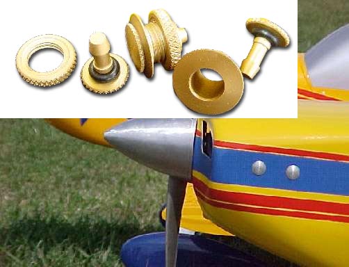

Do yourself a favor - hang it on the wall as a reminder not to buy everything you see that looks like it''s a good idea
Yes, they leak, they get plugged etc, etc, etc,
If you can''t get at the fuel line where it connects to the needle valve (Which is the easiest method) a fuel dot is the way to go.
A Fuel Dot is just a plug for a third line that goes to the tank which is used for filling and emptying the tank

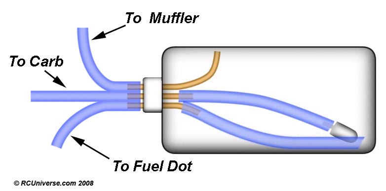

Sorry, it's an old drawing
Better?

Minn, I like the second diagram better.

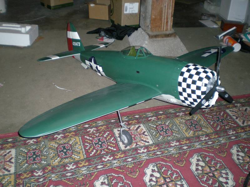

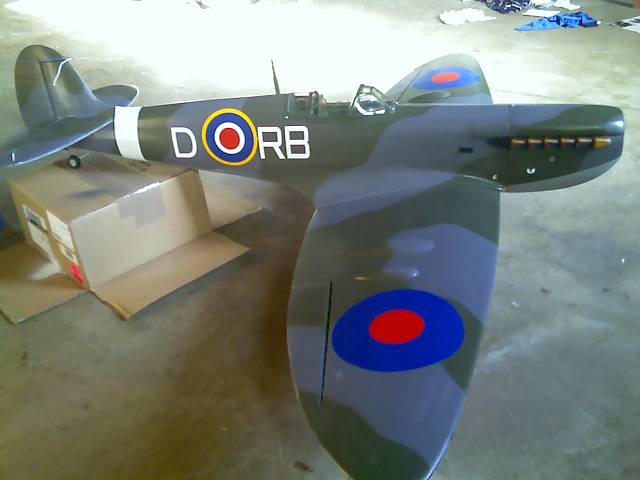

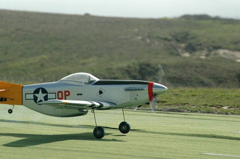

here's my fuel dot planes they all have em none leak,if you notice them getting a little sticky a little denatured alcohol cleans the gunk out none of the ones I fly have had any sticking issues,might be because I use fuel with low castor content,you can fuel, and defuel,through them.
if you let them sit in fuel for long periods, I can see where they might get stickey, but as long as you clear the fuel lines after flying there trouble free,I happen to like them for the hidden feature they can be mounted behind a cowl and the hole just needs to be the size of the probe to fuel the plane,as for leaking if you use a zip tie around the fuel lines going into and out of the EZ fueler there not coming off or leaking there.
Hangar-9 P-51 Mustang
Hangar-9 P-40 Warhawk
Top Flight,spitfire
Top Flight P-47 Thunderbolt
the P-47 should be getting its maiden wings pretty soon looking for a calm weekend.
