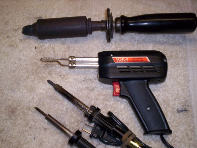

If you've any intent at all to stay in the Hobby/sport then now is the perfect time and job (piece of cake) to start learning. Over the years you could potentially do this one little simple solder job ltteraly hundreds of times for your self and others. Invest in an iron and some basic solder types start learning.
I am not talking circuit board work but plenty of other things from simple ripped antennas to soldered landing gear or soldered on wheel retainers, pushrod end fittings. How would you like to never agine experiance a lost wheel in flight despite how many flats you ground in the axle or thread lockers you tried?
Basic soldering is a modelers skill you won't regret making the effort to learn. Here are my indespensible soldering tools and I don,t do circuit board work.
John

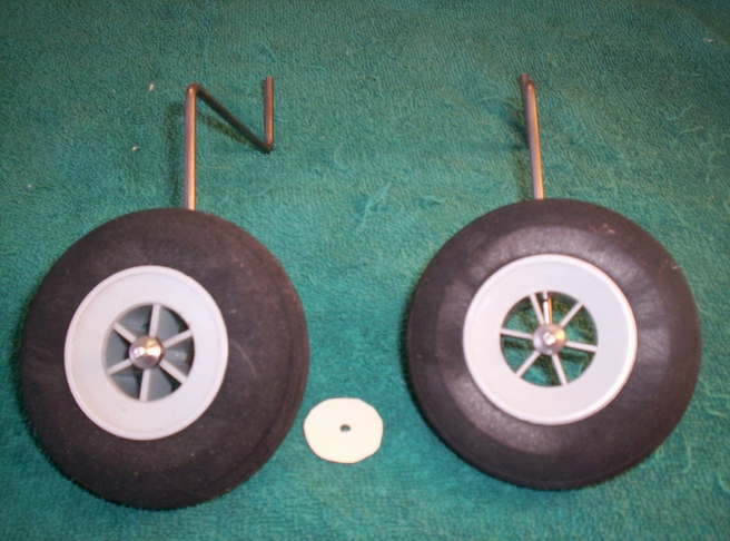

Here are some examples of soldered/washer axles and showing the process using a sacrificial paper washer so plastic wheels do not burn.
