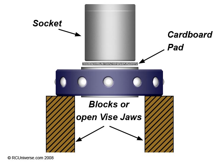

I didn't even heat mine I just opened up a vise so that the flywheel would catch on it, but the inner hub wouldn't. Then I got a socket just smaller than the flywheel, and banged the hub out of the flywheel with a small ball ping hammer.
Voila, good as new.
It really increased the rate of transition and may have even increased the top end power just a bit as well.
You won't regret doing it.

2. Remove the flywheel. You will most likely need a gear puller to get the flywheel off. The flywheel minimizes any surges in engine rpm. With the flywheel removed the engine will respond faster to speeding up/slowing down. REMEMBER TO RECHECK YOUR CG AFTER PULLING THE FLYWHEEL.
3. Remove the limiters on BOTH the high speed and low speed needles. The limiters are fine for people who have little or no knowledge of how to tune/adjust an engine. Once your engine is PROPERLY tuned you should not need to change the low speed needle and, AT MOST, a 1/8 - 1/4 turn on the high speed needle to compensate for humidity/temperature changes.
4. You will need a new spinner for a 2 blade prop. I suggest getting an aluminum spinner. They cost more (about 2 - 3 times a plastic spinner), however they hold up to electric starters and "unscheduled landings" substantially better than the plastic ones. You will have to actively work at destroying an aluminum spinner.
Removing the flywheel is easy. Place it over some blocks or an open vise so that the opening will allow the thrust washer (The piece in the center) to fall through.
Find a socket (From a socket wrench set) the is slightly smaller in diameter than the thrust washer and place it on top - it's a good idea to pad it slightly with a small disc of cardboard, but it's not entirely necessary.
Tap the socket with a hammer and it will slowly work its way out.
