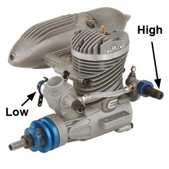

Are you turning the High or Low end adjustment? (See pic)
The next thing is, The Evolution TPS is an excellent engine, but sometimes they come out of the factory improperly set up. So even if you ARE turning the correct needle, 1/8 turn is probably not enough.
Here is what I would do:
First, remove the pin in the side of the High End needle that prevents you from turning it too much.
Bring the engine to as high an RPM as it will go and start adjusting the needle.
Once you get it to full RPM, see how well it transitions from Low to High and back. If it does this poorly, report back here and I'll go into detail as to how to adjust the low end on a TPS

Removing the pin alone may not be enough.
The blue collar that is affixed with a grub screw will also prevent the needle from being turned beyond the limiter.
The reason for this is that when you turn the needle not only does it rotate ( hitting the stop, which removing the pin fixes... ) but it also moves "in" as the needle uses screw threads...
The blue collar prevents this "inward" movement.
So you should also loosen the grub screw and remove the blue collar, even if you only do this temporarily.
Usually you will then find that the collar is almost impossible to remove!!!
Why?
The grub screw "digs" into the soft metal needle valve, and it raises a burr or ridge. In turn this catches on the aluminum collar preventing any movement...
You can work the collar off by carefully prying it up a bit at a time.
Once you have it off, get the engine tuned.
Once you have it tuned, turn the HS needle IN another 1/2 to 3/4 turn exactly, and put the collar back on, as far down as it will go, and re-affix via the grub screw.
Then turn the needle back out to how you had it.
Now should you ever need to remove the HS needle, you can merely bottom it out and back it out that 1/2 to 3/4 turn. This makes it easy to retune the plane later.
While you are at this, bend the HS "clip" in to provide more friction as otherwise the needles on this engine tend to walk.
Note that the collar business also applies to the LS needle too!
