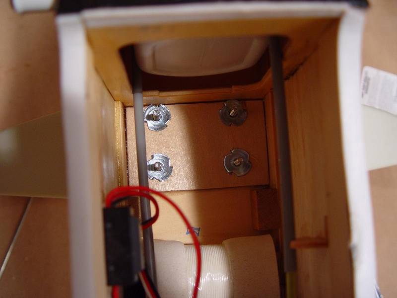

Here's a series of pics from my Avistar converstion.

ORIGINAL: krossk
yours was one of the ones i found through the search feature. how do you like the mains mounted where you have them? i also found 1 that was mount on the front side of that former, but it looked to far towards the front to me. and i was also just suggested to split the mounting block and mount the main at the former. but this is my first time bashing a trainer, so i don't know. i'm just trying to figure out the best spot the first time. since it will be glued in place. also i have the same main bracket

Interesting because I have my 2nd Avistar, and I'm planning on making it a taildragger. I think the previous examples will work for you just fine. I intend on putting the axles right in line with the leading edge. Put a piece of ply in front and behind that former. It looks like krossk uses a double pushrod off the rudder servo, one for the rudder and the other for the tail wheel. I'm sure that works fine, but I itend to link my tailwheel to the rudder. If you have your plane balanced correctly and the mains near the leading edge, you should really be OK. I did this same conversion to a Spad Debonair, and it handles better than I expected. Very rare to do a nose over. Just pay attention and use judicious throttle management while taxiing. Landing and takeoffs are pretty much the same.

well guys, i got the mains mounted up. i split the mount and put one piece in front of the former and one piece behind the former. and epoxied them in. this way the mains are right at the leading edge of the wing and right under the former. now on to my next question, what is the best way to mount the tail wheel ass. this is the one i have http://www3.towerhobbies.com/cgi-bin...?&I=LXFV47&P=0 now i would like to do this with opening up the tail section if i can. what do you guys think? thanks

ORIGINAL: gamesbeer1
ORIGINAL: krossk
Sorry for the delayed reply - I forgot to subscribe when I replied and have been out of touch for a bit.
I think the mains where they are located is ideal. I didn't fly it much last season, so it's been a while, but had no noticeable issues with T/O or landing. The wing w/o any dihedral was more of an issue for me - a bit twitchier than I expected, but that's another thread...
also, what did you use for the wood for the main mounting piece in the 3'rd pic? it kinda looks like luan, stuff the floor guys use.
It's regular 1/8 modeling ply (no lite-ply here). It was just a scrap piece I had left over from my boat racing days that had a rough surface finish that was unacceptable for exterior use.
ORIGINAL: jentzsch
Could us post a how-to on how you did the tail gear with more pics?
Sorry - that's all the pics I have. As far as the installation, I just screwed the Dubro tail-wheel bracket into the bottom of the fuse and added the wheel collars and control horn as in the pic. The toughest part was getting the Sullivan Gold-n-rod from the rudder servo to the tail. For that I took a piece of sharpened brass tubing and chucked it up in my drill and eye-balled the run from the rear of the fuse to the servo. Then remove the drill, but leave the tubing in the fuse. I then slid a piece of control rod through the tubing to keep the alignment while removing the brass. Then use the control rod to guide the outer (red) sleeve back through the fuse. From there, remove the rod and replace with the inner control rod. The pics show the rest of the control hook-up. I think the whole process took me about an hour.
