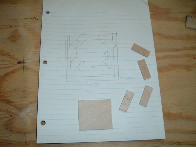

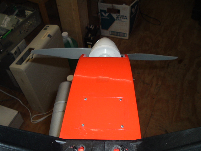

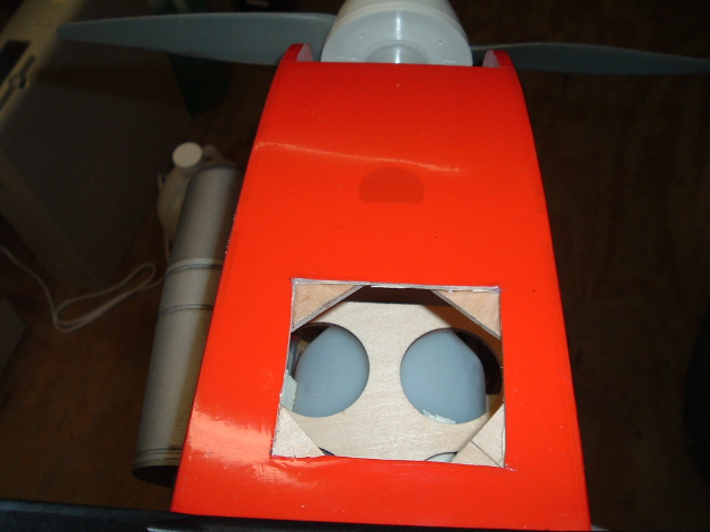

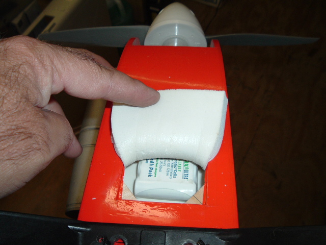

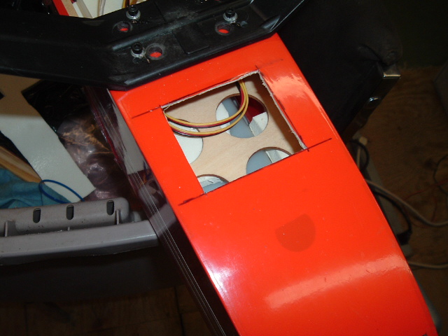

I would advise: Skip the smoke on this one, wait till later. The 91 is perfect, the servos don't really matter if they are digital or not, digital won't hurt, however. Start with a 12 x 5 prop, and see what your clearance is like from the tip to the ground, you may get to go to a 13" dia. It will fly with the 12x5. As you move up in pitch, you will have the speed that this thing should impress you with, I use mine for a fighter trainer, while I am building a P-47. If you start with the recommended CG, it does alright, but I ended up moving things around to get the CG toward the rear later. I put a hatch in under the tank to mount the battery, and didn't have to add any weight on mine.

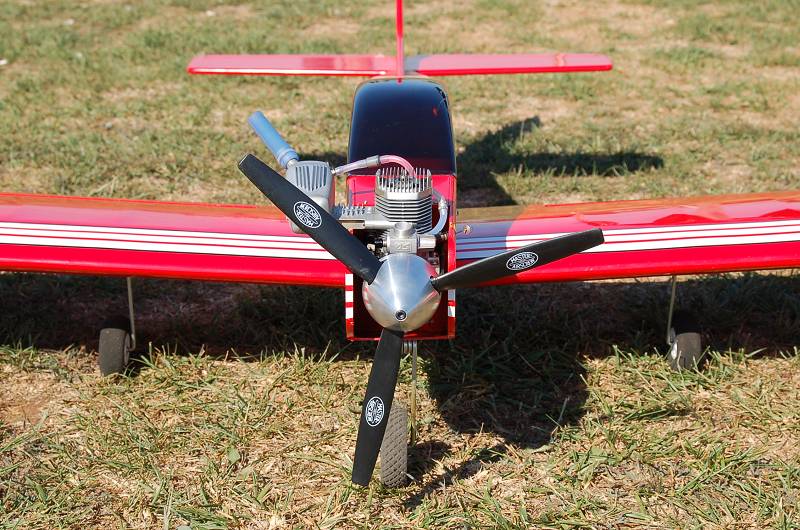

Second plane ????
Heck, how about FIRST plane. It's that steady.
Matter of fact, it's so hard to "tip stall" that it actually is hard to get to snap roll. And I've seen one fly on an OS75AX. Matter of fact, I see one fly all the time. Almost every time I go flying.
That 75 on my Tiger60 has a number of favorite props. I'm partial to 3 bladers because when they suit the engine/plane, they're often really good. Both the Master Airscrew 12x8(3) and the 12x6(3) do very well. For 2bladers, just about any 14x6 works good. The really clean looking Evolution 14x6 seems to maybe give the best all round performance of the 2 bladers, but truth is, the 3 bladers just seem to have an edge. It's probably from nothing more that suiting the rpm just a touch better. As it is, I've been meaning to try a slightly cut down 12x8(3) to see if that might not be the perfect setup, but got no real push to do it as the engine does so good with what comes straight from the factory.

Hey, that 3 blade really suits that plane. I like it! I will have to go out and buy a couple to see what happens.... Thanks.
Is that a Tru-Turn spinner? I just realized, I haven't seen many 3 blade spinners in any of the LHS.

Thanks. I also am wondering about the Spinner.
