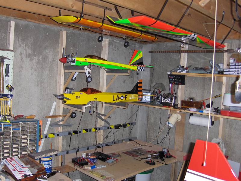

I build each airplane so the flight pack is easily accessable and remove it at the end of day and therefore no plane has a battery installed while in storage. When i chose a plane to take to the field I just take a flight pack and a spare with a field charger for the rare occasion that this system is not enough and I run out of power. I have 2 flight packs ,1 extra tx bat besides the one in the tx, and 2 bats for the onboard glow system if used, all on the trickle charger after an overnite charge when I got back from my last session. I use a 120volt trickler the can run all my chargers and go to trickle after 16 hrs of standard slow charge. I can then put all the batterys in the tx case and have one case to take to the field with plane. That way I don't have umteen planes sitting around with batterys in them just deteriorateing.
