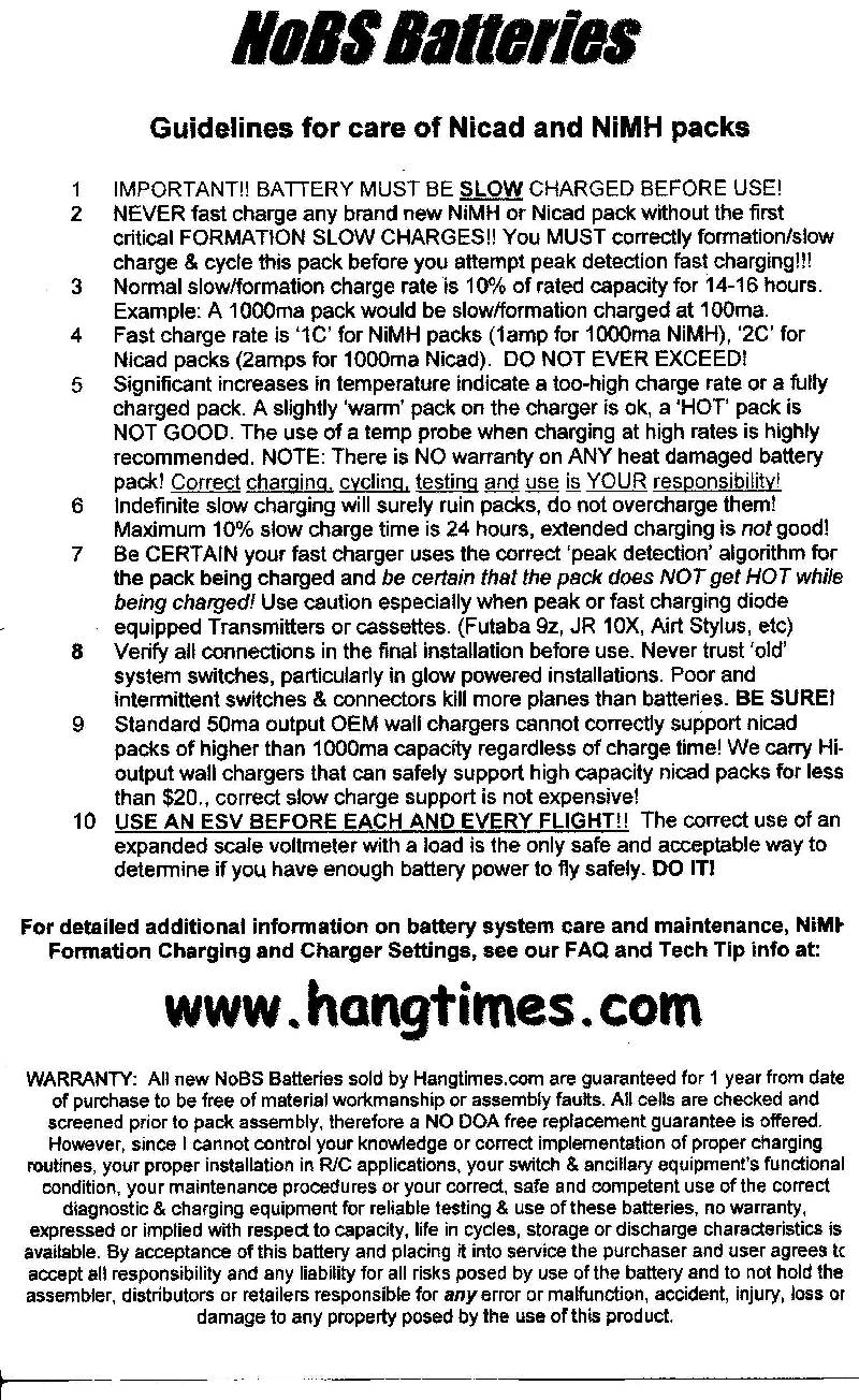

Here is some battery info which has yielded proper performance .
The "ESV" mentioned toward the bottom of the page, will ELIMINATE the "guesswork" with regard to battery charge status.

While an expanded scale volt meter is great to determine if your battery has sufficient current to fly again, it is not the tool required to test capacities, retention, and other factors, nor to safely charge your batteries...
However an ESV is a wonderful tool to have in your field box, and should be used after your first few flights of the day.
