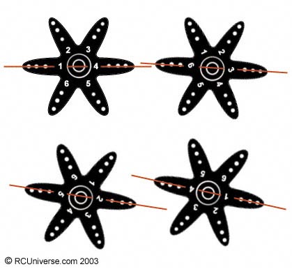

What John is referring to is that the splines on the servo don't have the same ratio of degrees as the arms, so that if you line up the #1 arm (look closely, each arm is numbered) and it is not centered, you can try the #2-6 arm.

<<What John is referring to is that the splines on the servo don't have the same ratio of degrees as the arms, so that if you line up the #1 arm (look closely, each arm is numbered) and it is not centered, you can try the #2-6 arm.>>
MY GOD! I never realized this! I never even considered the possibility! This explains why some of my semi-careful alignments seem to be slightly off after I snip the unused arms. I figured I was just misaligned when I replaced the horn - not that they were designed that way. Like most thngs - it do make sence once it's been 'splained.

I never knew that about the servo arms either. And how do you make those great drawings?
Yeah, please do tell. You seem to have a great graphic for every answer (or question).
By the way, I've been flying for 8 years, and I never knew this either. Does explain a couple things.

I'm a graphic artist by trade. Most of what you see here I created with Photoshop, Illustrator, and Dimensions (All by Adobe).
I will often draw something to better illustrate a point, then I save them all for future posts since the same question gets asked every now and then.
