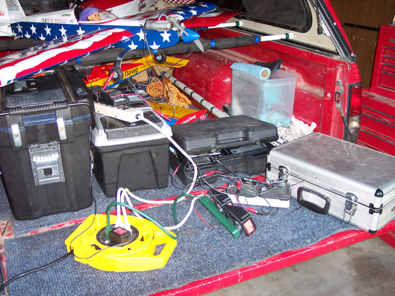

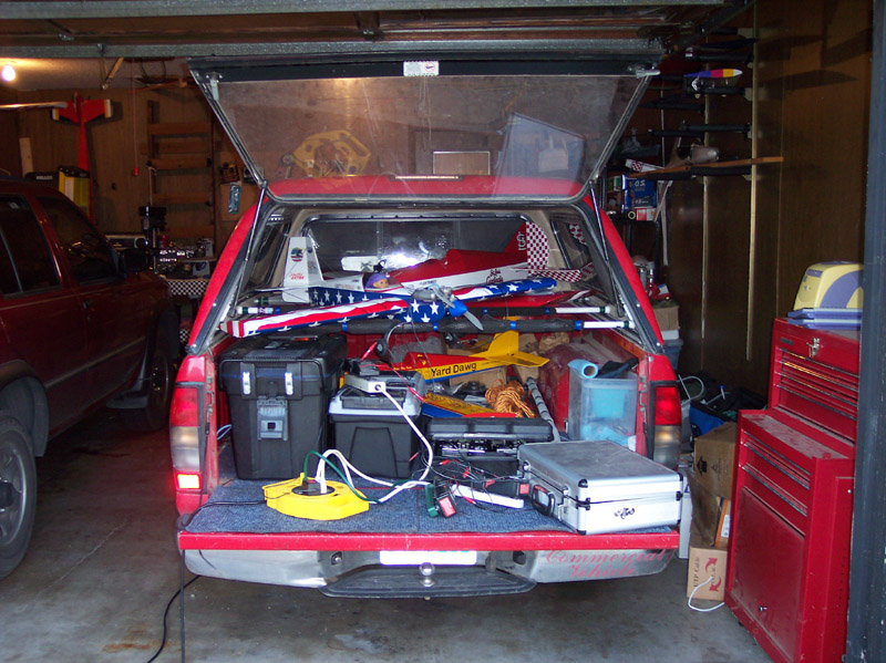

Old 05-18-2008 | 01:41 PM
RCKen's Avatar
RCU Forum Manager/Admin
Posts: 28,236
Received 31 Likes on 27 Posts
From: Lawton, OK
Default RE: airplane transportation
I have a Nissan pickup with a cover on the back. I use shower curtain rods wrapped in foam to suspend planes above the bed of the truck. It works great, and you can easily remove them if you need to load other things in the truck.
Ken

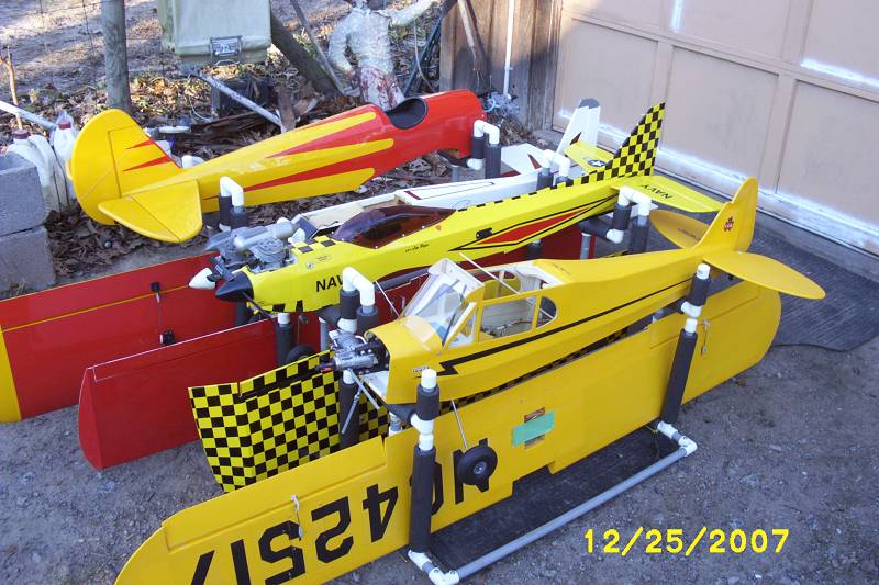

Old 05-18-2008 | 01:58 PM
My Feedback: (12)
Joined: Sep 2004
Posts: 654
From: Diana, TX
This is what I carry my planes on in the van. When I had the pickup, I built something similar, but lower profile and it
worked great.
I put screws in the tops of the posts so I could secure the fuselages and wings with rubber bands.
Good Luck

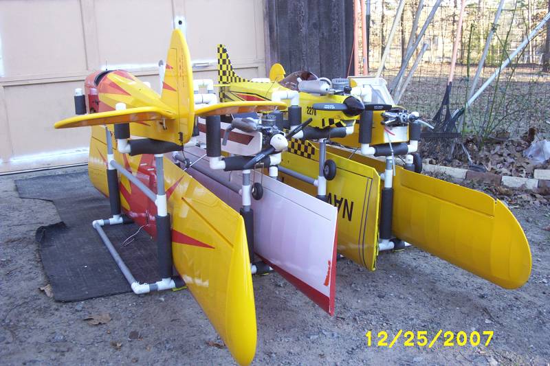

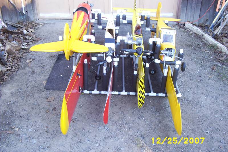

Old 05-18-2008 | 02:26 PM
Joined: Feb 2007
Posts: 47
From: Olds, AB, CANADA
I use a system the same as Safebet. I designed it to carry 4 planes. The only difference is that mine has PCV tubes that rotate over the top and latch on the opposite side. I place the unit in the back of my pick-up and then load the planes in there respective slots. Ithen use a cargo net over the top. I also use a cargo rachet strap around the legs but I really don't think it is nessary but I use it anyway. Wish I had a canopy or a trailer but have a wife and kids instead.

ORIGINAL: Safebet
worked great.
Good Luck
Very well done.
Any chance we could get angle, top, side and back pictures of your stand w/o the planes in it?
Why can't I find 90 degree 3 axis PVC connectors? I guess they are never used in plumbing...
Old 05-18-2008 | 04:40 PM
My Feedback: (-1)
Joined: Apr 2003
Posts: 14,400
Received 9 Likes on 8 Posts
From: Hemderson, NV
Don't forget to strap the stand into the bed, seen A few blow out. Use long scrap wood and rubber bands to hold the control surfaces from flapping around too, seen some servo damage after A long haul in the bed of A truck.

I also use a system similar to Safebet. But, be sure you use the thick wall PVC. My first stand broke at the base joint because I used the thin walled PVC.
Paul
