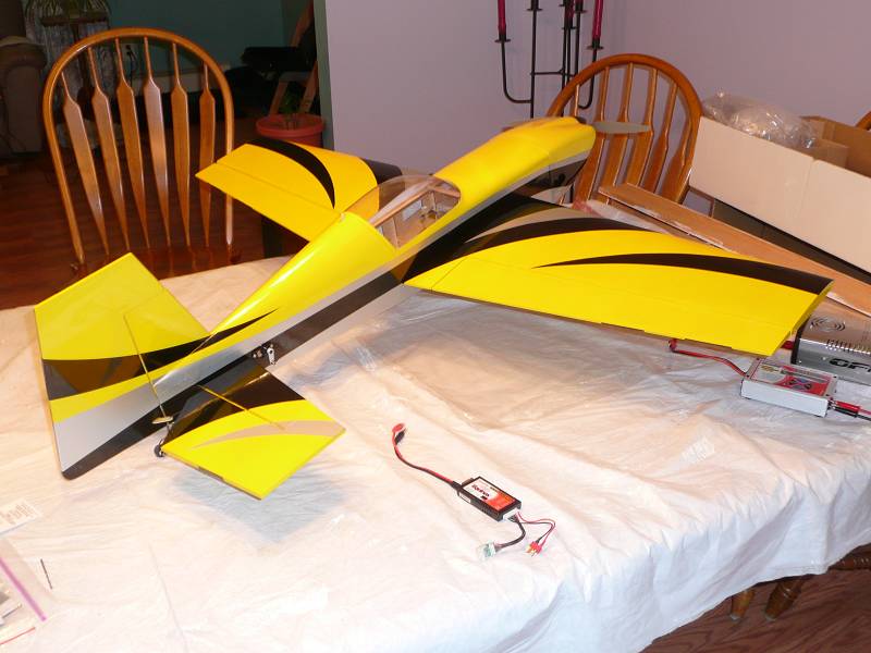

My new plane is done and all ready for Wed afternoon.

Rob, your plane is a beauty!!! I was not informed that my plane is on backorder. I called my credit card company and they advised me to dispute it (they've had my $$$ for 3 weeks now and still no idea when the plane's coming in, and they aren't posting $$$ back to my account). So, I have to wait a few business days, then try to find one online, in stock, and affordable. Already got all the accessories from Tower, so I'm pretty hooked on the Pulse.
