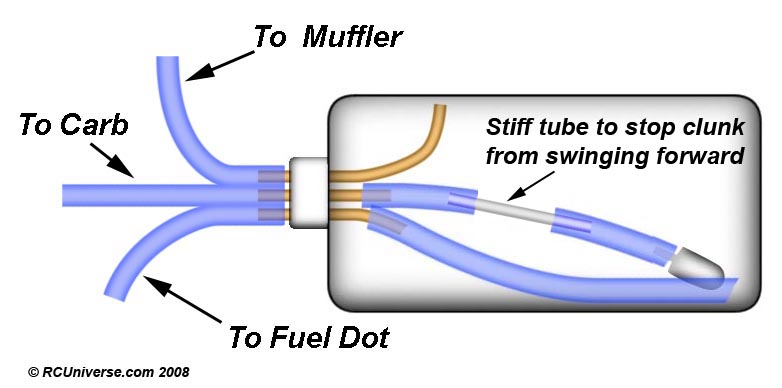

Below is the graph that RCKen posted, I believe that is what you are looking for.

I highly recommend using the 3 line system with a fuel dot for cowls. Anything that you add extra will be potential for airleaks. Keep it simple, and avoid having to chase down potential tuning problems later.

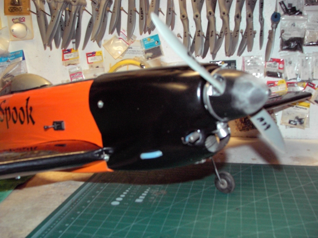

This is even simpler, requires NO fuel dot, uses only two lines and has the advantage of letting you perform pinch tests on your cowled engines.
It basically brings the fuel line out of the cowl, so you can fuel/defuel and perform pinch tests.

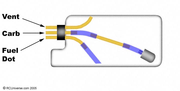

The picture of the 3 line tank plumbing has 3 labels for the lines.
The top label says VENT. Most glow engines nowadays run best with muffler pressure. This line is very often connected to the pressure tap on your muffler. When you fuel the airplane using the line labeled Fuel Dot, you discover that the tank is full when fuel overflows out that VENT line, wherever it goes. If it can quickly and easily get out of the muffler, you have no problems seeing that the tank is full just as soon as it is full. If the muffler layout doesn't do that, many people put a T in the vent line and run the extra line to wherever the Fuel Dot line goes. They have two lines sticking out somewhere and both are plugged. The attached picture shows how I do most of my airplanes.
The two lines are pushed into the cowl in the picture. That's how they are except when fueling. Pull them both out and remove the plugs to fuel. Into the front one that goes where the Fuel Dot line in RCKens picture goes, and when full, you'll see overflow out the rear one.

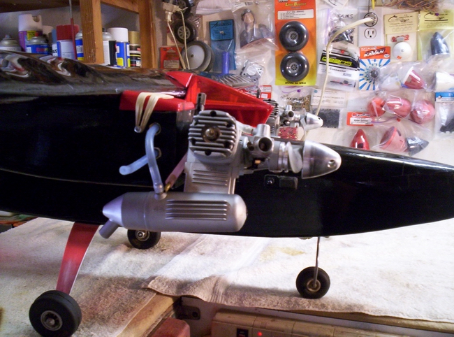

I actually didn't describe my plumbing setup because I use two different ones. I use uniflow most times, but will use what RCKen's picture shows for airplanes I'm not going to stunt much.
When you have all of your fuel lines enclosed and unreachable inside a cowl, you have to make at least one of them available to the outside world. You need the fill line available. A plugged line that comes through a cowl hole or a fuel dot on the cowl itself work for making that fill line available. But if your muffler isn't in the right place to show you overflow immediately, then you're going to need two lines available to the outside world. And that second line can be plugged or dotted too.
How does the T line work? Great. It's only use is to show the tank overflow. And that won't happen except when the tank fills and fuel starts to flow out the overflow. Yes, the overflow goes to the muffler and out the T line, but as soon as you see that fuel you stop fueling. It isn't a big deal. And if you want, you can arrange the T in the line so the overflowing fuel's momentum goes straight through the top of the T to the outside world instead of the muffler. Works great and the muffler pressure doesn't care if it's got to make a right angle turn.
With either uniflow or conventional when you have two lines showing to the outside world, you unplug them both to fuel. One will be the fill and must always be used for that. You unplug both lines and fill into the correct one. When the overflow appears out the overflow line, you stop pumping and plug both lines.

Two stupid questions:
1) Stated above in post 9 jetmech05 says to use two clunks. Is this correct? One on the pickup line to the carb and one on the fuel dot?
2) When you refuel, disconnecting the vent line to the muffler, and using the fuel dot won't the pressure of fueling push some of the fuel up into the carb through the pickup line? Or does the clunk prevent that?

If you can access the pressure line at the muffler, use that line to fill the tank. Stand the plane on the spinner and if you think about it, close the intake window on the crank. Now simply gas it up until fuel spills out the carb. If you are a "neatness freak", just fill a pre-measured amount with a syringe.

But to answer your questions above. Yes, you can have two clunks in the tank. The first one is on the fuel pickup line that goes to the carburetor. The other clunk is on the fuel fill line. This will allow the fuel to be pumped out of the tank. You can forego the clunk on the fill line and put a simple piece of tubing bent down to the bottom of the tank at the front of the tank. To pump out the fuel simply lift the plane up on it's nose so the fuel flows to the front of the tank.
The only time that fuel will come out the carb when fueling with a fuel dot is if you have a T-fitting in the fuel line, with the "T" hooked up to the carb, tank, fuel dot. But you can simply close the carb before pumping in the fuel. In a 3 line setup this usually isn't a problem because overflow will go out the muffler pressure/vent line first.

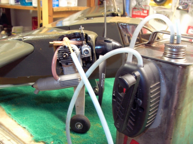

You can actually have NO plugs or trick fueling devices at all in a 2 line system on a cowled airplane.
