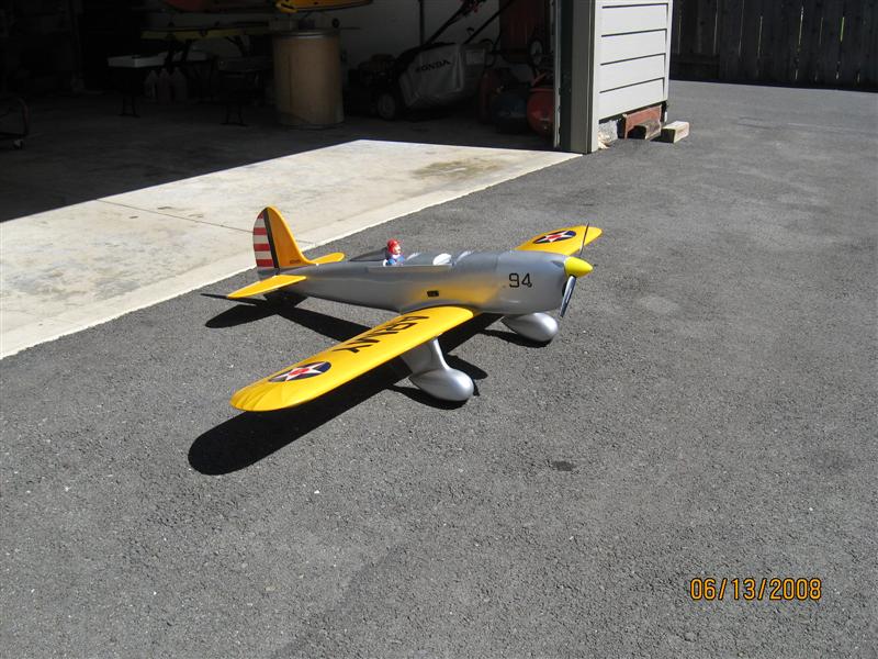

I use 2' by 4' accoustic ceiling tile, works pretty well. But where did you find the Sig Ryan STA? I'd sure like to try one. I've been "assembling" a Nitro Planes Ryan PT 20 and it's pretty much junk. Really difficult to make it fit and the end result is not very satisfying.
