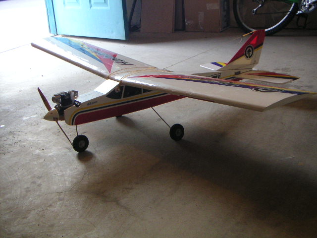

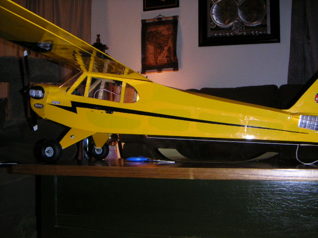

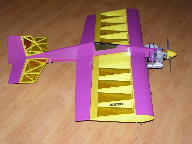

The antenna tube in the fuselage is about the cleanest. It will leave just a little excess hanging out. Many of the nicer ARF's and kits are designed with this option. Another clean way is to run is out the bottom of the fuselage just behind the wing. Glue a piece of fuel tubing through a hole there and pass the antenna through it. The tubing will keep the wood from cutting the antenna or the antenna from cutting into the wood. Then make a hook from a discarded servo arm and use a rubber band to connect the end f the antenna to your tail wheel bracket or eyelet screwed into the rear of the fuselage. The rubber band will hold the antenna wire straight and tight without over-stressing it. I also like to use a piece of servo arm to make a strain relief at the point where the wire exits the fuse. This prevents the wire from being pulled out of the receiver.
You can kind of see what I'm talking about on my old Cub. You can also see the tube I put in the right wing half on my scratch built profile Hots. It was easy to do on the scratch build since I could plan for it during wing construction. It really wouldn't work on a removable wing unfortunately. I'll toss in another shot of my old Tower trainer with the antenna going to the tip of the vertical stab.
