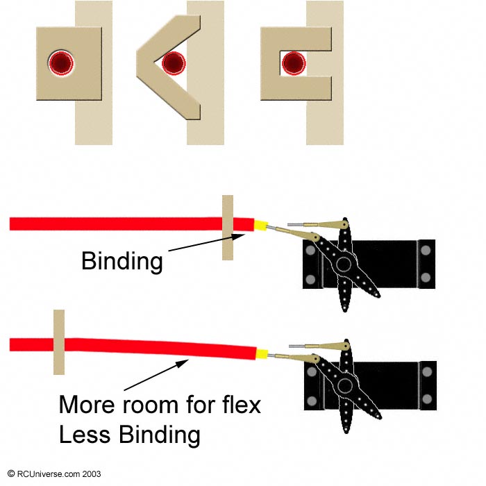

Near my servos on my Kadet Senior, I had to move one of the nylon or plastic tubes that the control rod rides in down in order for it to function without binding. I have tried CA, Epoxy, and Silicone, nothing will hold it permanently. Anyone know how or what to use to secure this? Nothing seems to stick to it at all.

One thing that is bothering me is that it seems that if the front tube (meaning the one near the nose wheel) is not able to move (if I were to glue it in place) I would get some major binding..
Any fixes?

Ok, I think I see what's happening here.
The outter rod needs to be securely glued (BTW, scuff the surface with sandpaper and use CA. Epoxy doesn't stick to plastic [that's why plastic coffee can lids make good epoxy mixing trays]) If possible, surround the rod by either running it through a hole in a piece of scrap, or just attaching it to a former with a "V" shapped scrap.
BUT!!!!
Do NOT secure the outter rod too close to the servo! As you know, as the servo arm swings back and forth, it also swings somewhat side to side. The outter rod needs to swing with it. See pic.
