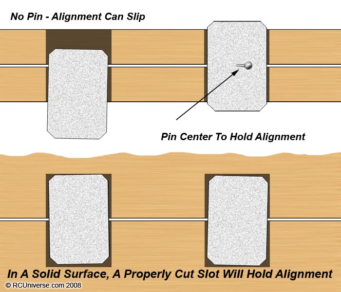

I have a new ARF to build and the hinges are CA type. I've never work with this. The manual explain to first install the hinge into one surface and add CA ( not mentioned but I guess thin CA is recommended ? ). Then, they instruct to install the second half of the hinge into the second control surface and add CA to it. To me this is a bit strange. I would have install the hinge to both surface and then add the CA to the hinge. This way you can slightly move the hinge to get a perfect fit. What is the best way of doing it ?

The main point here is not a complaint about CA hinges because, like the old 'ford vs chevy' debate we've heard so many times, this is about technique. This is basic synopsis of Minnflyers instructions.
First of all, do NOT apply CA until the hinges are installed, with the proper hinge insertion depth (equal on each side), pinned through each surface to hold them in place, with the gap is properly set (of course, set the gap before pinning them in place).
Then bend the (I will use aileron as an example) aileron to max throw but not beyond, so you don't pull it out. Apply CA to all the top (or bottom) hinge sides first. Flex the hinged connection, meaning if you are doing ailerons, flex the aileron up and down a few times.
Then bend the aileron the opposite way exposing the other side that has not had CA applied, and apply the CA on all of the hinges on that side.
When done, remove the pins and flex the hinges again to make sure you have full movement. Full movement means that it will freely travel up an down within th manufacturer's throw limits.
DO NOT reapply CA once done. One application is good. Two applications can be disasterous. This does something to the bond and will cause it to fail in the future.

ORIGINAL: CGRetired
Close, but no cigar.
You do NOT pin the hinges in place.
IF the surface you're hinging (Let's say elevator to stab) is built-up, there is a chance that the hinge can go too far into one side or the other, so a pin in the CENTER will hold the alignment so it can't go too deep into the stab or the elevator.
Also worth noting is that if both surfaces are solid, and you didn't cut the slots ridiculously deep, the slots themselves will keep the hinges from going too deep and the pin is not necessary.
But please. read the "How-To" for the rest of the instructions. It's written in very clear, easy-to-understand wording with illustrations.

Mike: I was once told, and I don't rememer who it was that told me, that it was a good idea to push a pin through each side to hold the hinge in place. Now, that I think about it, your method does the same thing, doesn't it. Sometimes it takes a little bit of observation and a clarification from others (as you) with much more experience. Thanks for correcting that. I will adjust my 'building' technique accordingly.
CGr

DIck, where you may have gotten confused is that some people will pin the hinges into the wood AFTER they have been glued in as an extra safety measure. I even did this once when the CA I was using was old and starting to thicken (so I was afraid that it didn't soak in properly).
