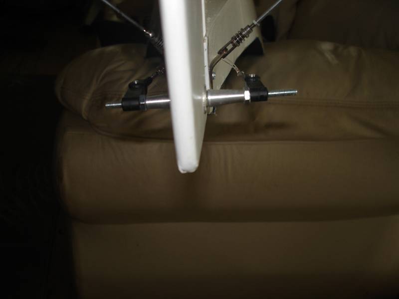

I was reading some reviews and i came across this term pull-pull system what is it ??
and anyother terms would help please and thank you

Pull pull refers to a surface being moved by a cable on both sides of the surface, normally these are metal cables...

One reason 'pull-pull' systems are used is because a cable, rod, or string under (pulling) tension will remain straight, while a rod or stiff cable under (pushing) compression has the tendency to deflect under load. Pull-pull systems are more accurate and provide faster responses than using traditional push rods. They also allow you to use lighter and more flexible materials.

Here is a picture of my pull-pull system for the rudder on my SeaMaster 120. Hope this helps.
