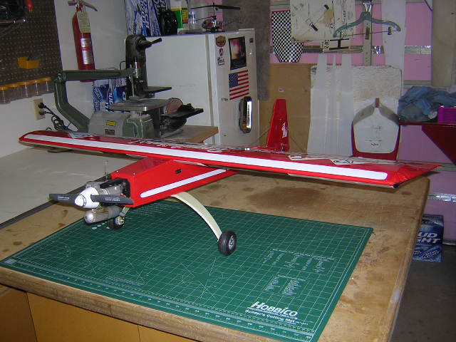

They must have really made a gutless design with the AX. I've had the 46 FX for 5 years now, and right now it swings a 14X4 APC, and it has plenty of grunt.
Edit - 11X6 Scimitar on that picture. But that's the plane it is currently on.
