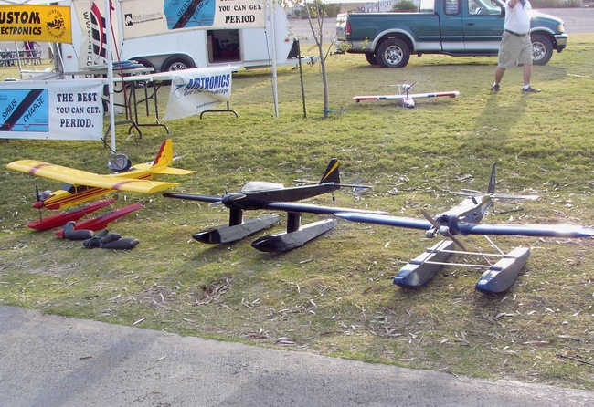

I am going to get another alpha 60 and was wondering if it is possible and a good idea to put floats on it. I have a friend who likes boats so it would be nice if we could go the lake and i can fly and he can drive his boat. I know it is a good idea to fly with wheels first but i would eventually like to put floats on it.

They July AMA magazine has a lot of information about float flying. Trainers tend to make excellent float flyers, but make sure you don't skimp on the power plant. The floats add weight, drag, and getting the plane off the water requires more power. The plane is going to be even more difficult to bank for turns, so give yourself plenty of control throw at max. There is a float flying discussion group as well.
Float flying requires MUCH more refined technique for take off and landing . You cant force the plane into the air, and you can't just drop it down on the water. You also have to make sure you have the floats mounted correctly in relation to the CG of the plane.

I had plastic floats on a trainer then later a fun fly. Flying off of water is fun.
Not for the beginner though. The play will REALLY fly different. It will have a different feel in the turns.
The floats act like a pendulum as well as sails. On mine, It flew better when I used a little rudder in the turns w/ the ailerons.
Definitly need power. Short takeoffs will keep down the misaps.
Wind and chop will make taxi and takoff unenjoyable for the novice.
Step location on the floats is important.
CG is important.
Water rudder is REALLY important. I can't tell you how many had to abort our bi-annual float fly because their water rudders were not effective enough to turn in the wind.
Flopping over in the water and soaking your electronics is NOT fun.
This IMHO is NOT a project for the first year novice.

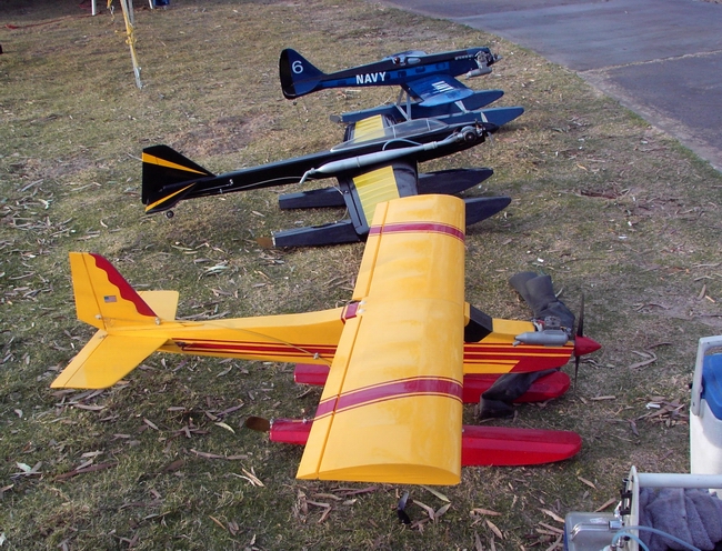

Default RE: floats on a trainer
ORIGINAL: F-18
Of course the airplane is a fine choice and your plan is a good one. Most trainers make excellent floaters however I normally suggest not using something with rounded fuselage such as the Nexstar as this makes a good installation more difficult.
The key parameters for success in float installations is pay close attention to the step /CG relationship and the wing /float deck incidence relationship. These two points can make or break a good installation. Float flying does not need oversized engines as some will say but rather good float installations.
Float flying is not at all difficult it is only a little different and normally not a problem at all for someone just off the trainer on wheels and willing to work with a float mentor.
Here are a couple of my ships and the trainer of a young man just off the trainer getting his feet wet for the first time.
