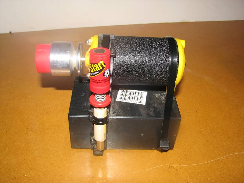

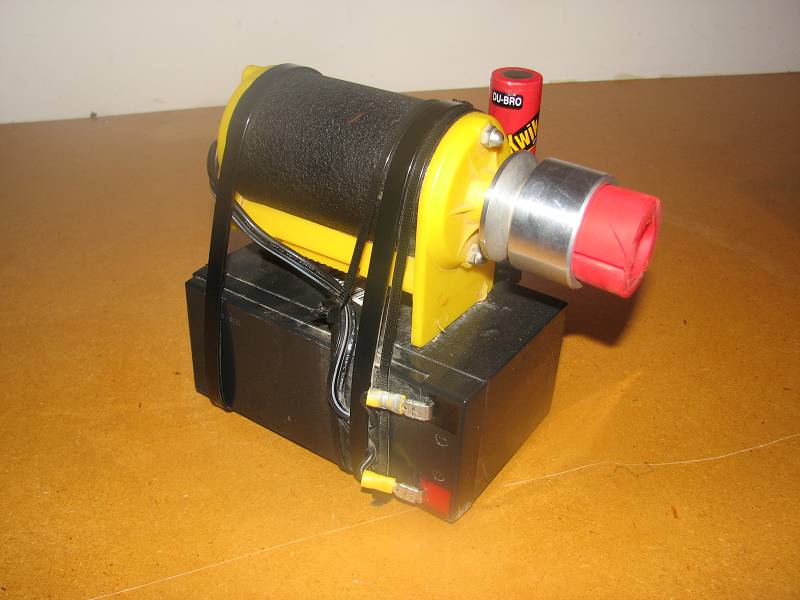

Go with the more inexpensive version. Get a 12v 7amp gell cell and place your starter on top of it. Get a couple of large, really large zip ties and zip tie the battery to the starter. Then just simply connect the starter's leads to the batteries. There you go,,,easy, very dependable, inexpensive and will last about a month or even more before you need to recharge it.
I'm on my laptop now, but if you need a pic of my setup let me know. I have a pics of it on my desk top.

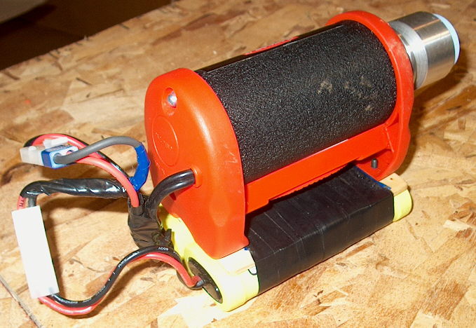

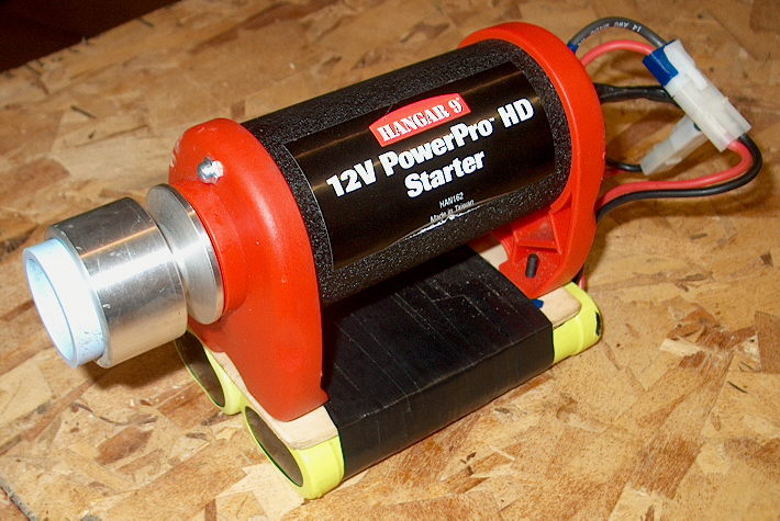

One of the guys at the field had one of those type and it worked for a while but he doesn't use it anymore, I think it wouldn't hold a charge anymore. Here's a picture of one that I put together out of cheap NiCad packs. It works great. You have to wire it so that you get more amps and not more volts.
take care
Yes, I would really appreciate a picture.

ORIGINAL: rclement
That's something like what I saw at the field that I mentioned.
How much were the batteries, can you send me a link to one, and also, do you know if you can recharge that thing using a Multiplex charger?

Here you go. I used to use the nicad packs as well, but they just simply didn't hold a charge and you'll need a charger that is able to charge all 12 cells. So I went with this. I've been using it for about 3 years now.

ORIGINAL: cruzomatic
Thanks - What do you use to charge that?

ORIGINAL: rclement
How do you wire it so you get more amps and not more volts?

It's actually pretty small, so the alligator clips might be a bit cumbersome, not sure, but I'm sure you could make it work. And your Multiplex would charge it just fine.
What do you think of the setup rclement sent - see his photo. It looks more compact and I like it. Where do you get batteries like that? And what does he mean about wiring for amps and not volts, do you know?

Looks good. There are a ton of ways to do this. One guy got a 14.4v Black and Decker Power tool battery pack and uses that; recharges with it's own charger in 15min, yet lasts for days and days.
The battery I linked to is only 2"x3"x1" approx. It's really small and compact, and you could do similar wiring to rcclements.
I don't know enough about wiring to give advice, but batteries can be wired in parallel or series. I don't know which you would need (I haven't taken my electro classes yet)
Old 07-05-2008 | 11:44 AM
Joined: Oct 2005
Posts: 140
From: Tyler, TX
Default RE: Starter Battery Pack
To get more current (amps) wire positive to positive and negitive to negitive.
Old 07-05-2008 | 11:49 AM
cappaj1's Avatar
Joined: Jun 2008
Posts: 939
From: Rochester, NY
Okay - that's what I would have done anyway. I would have thought the other way around would reverse the direction of the starter or cause some malfunction.
