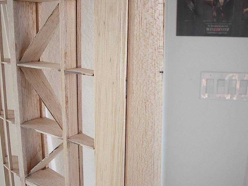

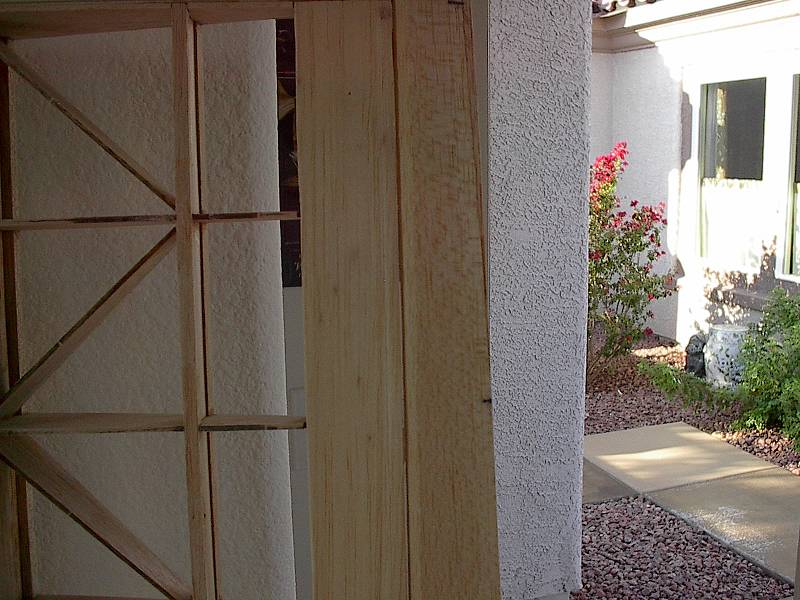

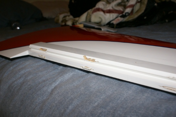

Well I just got mad and cut the hinges. The gap was bad. Heres some pics. What should I do now? [:@]

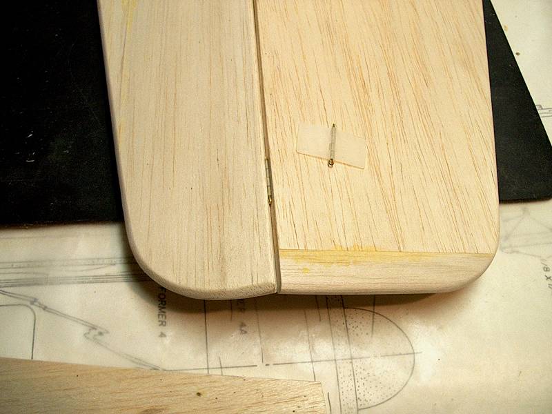

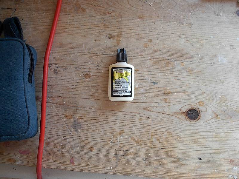

El, those are great hinge pins and have there place, I use them A lot. If you had problems with the type you just used then the pins may not be for you either. Planes have to be set up in advance for hinge pins too and there can be some problems with foam cores so you may want to give pins some thought and study.
With the Dubro type like you used you may want to buy some hinge glue instead of CA. Just read the back of the bottle and it tells you how to use it. Putting A bit of oil or greese along the brass hinge pin helps keep any over flow from sticking. The hinge glue can be wiped with just water. If you just cut A small channel into the leading or trailing edge these hinges can be installed with almost no gap.

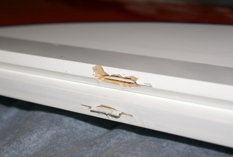

ORIGINAL: ErikElvis
Yowzer! You need to listen to soothing misic while building or somehing.
At this point I would say remove all traces of hinges. Use epoxy thickened with balsa dust to fill the wounds. You have seriously compromised the structure of the wood with those excavations! Find some Nylon hinges and USE EPOXY to attach them. CA is best for Mylar/fiber hinges but NOT Nylon or plastic. After all, it comes in a plastic bottle and doesn't stick to that. ;-)

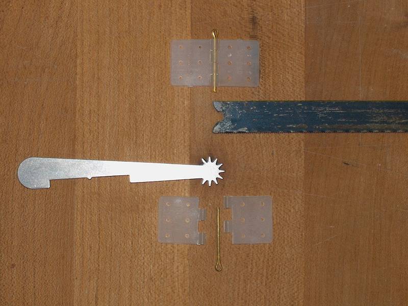

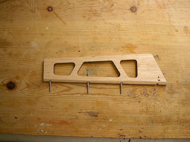

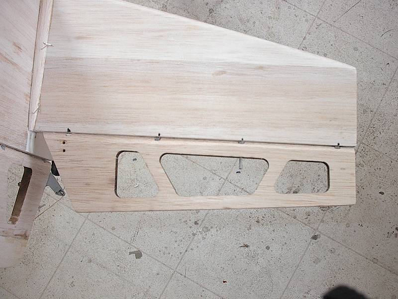

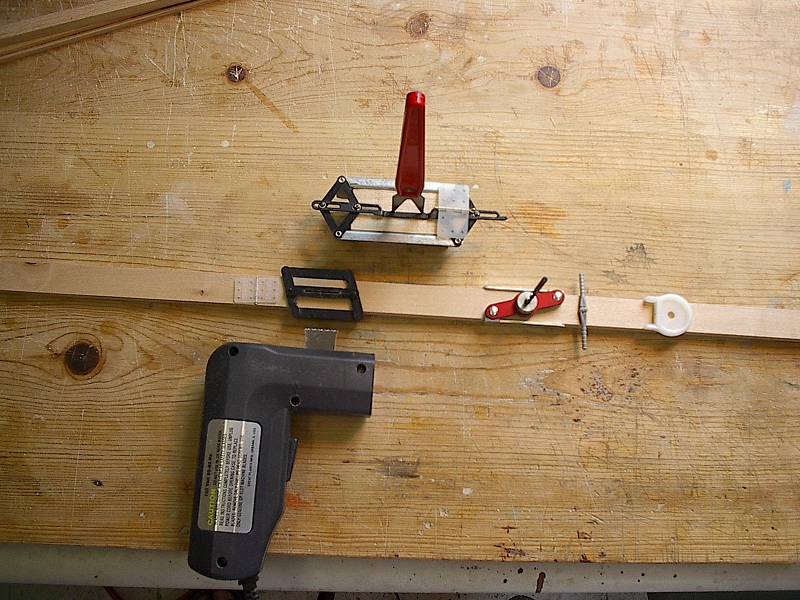

Vasoline is another good item to use, so is greese or any number of other slick items. The key is to just not go nuts with the stuff and keep it on/in the hinged area only. Pacer Hinge glue is perhaps the better item for the flat hinges. Epoxy is OK for hinge pins and if the holes are wobbled out some then expanding Gorrila glue can also be used. If the holes are nice and snug then again, I like the Pacer. Acetone will not melt A Dubro hinge or any hinge made with that type of plastic.
Now the picture and the 1000 word thing. They make slot and hole guides just for installing hinges. I'm showing you three types. The little white thing on the right is another cool little tool, you just slide it down your TE or LE and it makes A shallow groove, I have gotten mine out of old kits but I think I have seen them on the rack at my LHS.
For hinge pins you need to cut A slot so the hinge of the wood will be flat with no gaps. I have also used A burr on both the LE and TE to round the wood so the pin goes flat.
Hing pins are the easiest to use [MHO} but can't always be used. On this 4* I have flat hinges in the ailerons and pins on the elevators and rudder. Why you ask?? Because I'm teaching A student how to build and hinging is part of building!
