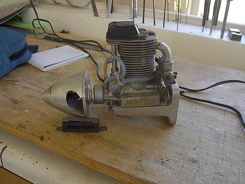

I'm going to show you an old mount I have from the pattern days, I have A couple of these too. They don't say who made them on the casting but I "think" they are Dave Brown anti vibe rail mounts, these don't flex and there is no vibration. I know I got them through Central some time ago. The Hyde nose ring mounts work great but that would be the first Magnum 70 I have ever seen needing one. I also have the solid OS mount for my OS 1.20 and I use the Jtec anti vibe on my YS 1.40, I love that mount but it's not an easy one to install on your fire wall but it sure works!!
There really are A lot of good mounts out there to choose from. Have you mounted that Dubro some way different?? Just wondering, A .70 Mag pulling it over???[:-]

Grey Beard, the only thing unique about the mount on this plane is that I first set it up for Mag 52. I found I needed around 7 oz up front to balance, so seeing that the Mag 70 is just about 7 oz heaver than the 52, and I had one, I decided to use it. I didn't want to put a second set of holes in the firewall and the differece in widtth wasn't that great, so I milled out a set of the mounts to keep the 52's firewall pattern but accept the 70 without distortion.

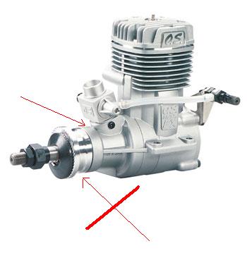

I need to get this right too please! Looks like the nose ring is holding the non moving part of the engine just before the drive washer .Wouldn’t that though put a lot of stress on the engine body? I used the same Dubro soft mount for an OS70 4s on a trainer last month. Well the trainer did go down in an uncontrollable fashion and crashed .I believed at the time that that was due to elevator’s clevise/ horn clip got undone. In that flight I had used the Futaba 7c 2.4 GHz system, the soft mount and the new trainer all for the first time. It couldn’t have been due to the vibrating soft mount could it?

Glad you got it working better by reworking the mount... much simpler than adding a nose ring. And to confirm, if you should ever use a nose mount, yes, it supports the non-spinning portion of the motor at the nose where CGRetired indicated in the picture. If it is kicking on the ground, I'd say it is kicking in the air too. But this is probably not a big deal if the movement is small and you aren't trying to fly super precisely. Fuel up and enjoy. - Cheers

Are the mounts tightened on the photos you are showing?? Just looked loose to me.
Only plane I have the Dubro mount on right now is A very old Bridi Kaos 120. I removed the engine and mount from an Extra I sold. This is A small 1.40 22cc gasser from RC Showcase, you can see where I had drilled/cut out the side of the mount for throttle or choke clearence. With this engine in both planes there was no flex or any problems. After I get the mount snugged down onto the fire wall I do use A torque wrench just to get it all equal. Can't remember the torque right now but I do have it writen down. It isn't sinched way down but there is some squish in the rubber.
Grey Beard, the design of the mounts gives you a hard mount to the firewall, the two aluminum centers and the screw. The mount floats, but is trapped on the aluminum centers. I think the big difference is that the four stroke mounts are quite a bit longer than the 2 storke ones. That and the fact that the carb will interfre with one of the screw heads requires the engine mass to be an inch or inch and a half out front of a 2 stroke. It gives a little extra leverage, along with the low pitch prop and the torque from the four stroke.
I kind of agree that the rubber isn't tightended down, but if you notice that in the photo of the long and short aluminum centers the one rubber bushing was damage from being trapped between the spools because they were to short. I don't think shortening the aluminum centers is the answer. Maybe a shim between the aluminum center hubs and the bushings would work OK. Although I think I'm Ok with what I have now. It's not giving the snap to the side I saw eariler but a gentle change at full throttle, and then only during the spool up to the final 500 rpm or so.
