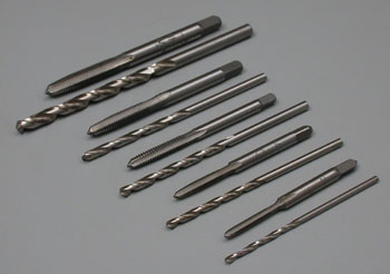

I meant using something like this: http://www3.omnimodels.com/cgi-bin/w...I=GPMR8108&P=0
The drill is the right size to allow the tap to cut a good set of threads in the hardwood block.
Then you use a regular bolt screwed into the threads. I used 1/4-20 nylon wing bolts (cut to a shorter length) to attach the gear to some of my planes. One has 10-32 nylon bolts, and one has two 8-32 steel bolts.
The plane with 8-32 steel bolts is a Tower Hobbies Uproar 60. It weighs about 7.5 pounds and the two screws hold the gear just fine.
All of my stuff that has nylon bolts uses three or four of them. My planes are all 60 size and weigh from 7.5 to over 9 pounds.
