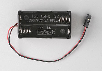

If that charger will charge that single cell battery, go for it. There are several adapters that you can get somewhere, probably Radio Shack, that you can mount the battery (s) into and creat a battery pack to charge with that charger. I don't know what the limitations are with that charger.. four cell packs for instance.. would limit the thing to a 4.8 volt four cell pack (duh). But, looking closer at the picture you included, it does say 1 - 14 cells, so I would have to assume that it would be alright.
http://www3.towerhobbies.com/cgi-bin...&I=LXFVC8&P=FR
The below link with Tower Hobbies shows a four cell battery holder so, as I mentioned, I am sure you can probably get one at Radio Shack. You can either make up an adapter to work with the lead on the holder or go to Tower again and get one of these:
http://www3.towerhobbies.com/cgi-bin...?&I=LXL332&P=M
One small note.. you would not want to use a battery pack like this on a glow powered aircraft, and would really, seriously, not use one on an electric powered aircraft either. The vibration could really cause problems with intermittent connections to your receiver and you really don't want those sort of glitches. This is fine for a camera, but probably not a good idea for an RC aircraft.

On one end is a "banana" plug that goes in your charger. On the other end of one pair of leads (when you buy them, they come in pairs like that.. one for a TX and one for an RX) you have a typical Futaba type servo type (sorry for the redundancy) connector. In the case of that picture, I think that it is Hobbico...probably Futaba, but pretty much universal. No, looking at it, it says "EA"..whoever they are.. but it is just fine for this application.
As long as RED goes to RED, goes to Positive ( + ) on the battery and the BLACK goes to BLACK goes to the Negative ( - ) on the battery, or the battery pack.. you're all set.
If you look clusely at any typical RX battery pack, you will see four cells connected in series. The connections are 'welded' in place and done very quickly so as not to damage the battery internals with the heat. My telling you this is because the typical packs consist of the type of battery you are working with here... so it will most likely take a quick charge (1C at MAX!!! or no more than 2.1 Amps) and it will charge in one hour or a little longer.. (10% overhead so make that about 1 hour and 6 minutes or so). It is always best to slowly charge batteries.. 1/10C is just about right, and they will last longer.. but 1C will most likely work.

I already have the Futaba charge leads http://www3.towerhobbies.com/cgi-bin...&I=LXL332&P=ML
and just wanted to know if it'll plug right into http://www3.towerhobbies.com/cgi-bin...&I=LXFVC8&P=FR
Sounds like from what you said it should.
