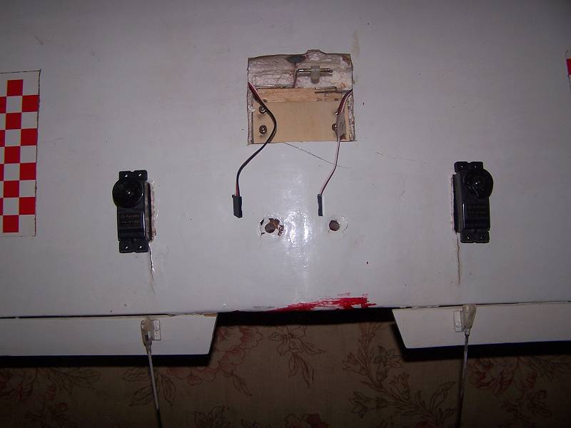

This is how I have mine mounted on my Senior Falcon (which is supposed to use a center "bellcrank" servo, but the bellcrank system just doesn't work right in this plane). I outlined and cut 2 "slots" out of the wings in line with the control horns (and used the existing control rod exit point as a reference). Then I chopped out the internal foam core and stuck the servos in. I later added 2 small peices of wood glued to the wing to screw the servos into for extra support.
I don't know how well it's going to do as I haven't gotten it airborne yet.... my new tank should be here this week and ALL the peices will be in place
..... but Mac's right, what do the instructions say? I've seen wing servos that were mounted sideways inside the wing and the wing panel was bolted on top of it with JUST the servo horn sticking through and I've also seen them bolted on sideways. Which way is the "right" way is probably dependant on what kind of plane you're flying. Mine is a 70" wingspan "trainer" style, so a little extra near the fuselage on each side isn't going to matter much. On the other hand, if this was a sport or aerobatic plane, it might make a HUGE difference in handling....

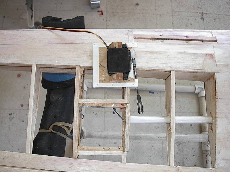

I think there is more than one good answer or approach to this question. One good method is to make a hatch or door or panel that has the servo fastened to it on the inside. The servo arm sticks out and the clevis and pushrod are external. The SIG Four Star Sixty
uses this technique. A slightly longer servo arm may be helpful.

OK, I took A shot of A plane I'm starting to recover, this should sort of give you some ideas. The hatch is an easy way to mount the servos, how you mount the hatch is up to you, I use corner gussets, beams and anything I can think of, all depends on the plane and how much room I have to work with. First shots are the normal old hatch with beam mounting. There is rib cap stock around the hatch so I have something for the covering to go onto. Very easy way to do it. The big red wing is an ARF, I haven't A clue as to who made it. The servos are mounted inside the wing straight down/in and also an easy way to do things. There are just two hard points glued/epoxy in the wing for the servo to mount into fore and aft. The fuse you see is another easy way to mount servos on A sheeted surface. This is A Giant Scale plane that the ARF people decided only needed one servo in the fuse to operate the two giant elevators with A stick and two wires to operate each side?? I just cut out the fuse, added some ply on the inside of the holes for the screws and mounted A servo on each side. I have done stuff like this on wings too. Just let your mnd wander A little and you will come up with something. When I set up the plane OZ is showing you it was designed for two wing servos but it was almost the same as the first two photos I'm posting. As I recall the servo hatch just mounted A little different and I did use after market servo arms on it too, sometimes you just have to use them. SIG gives you the hatch but you have to epoxy in the mounting rails for the servo size you are going to use. Hope this helps some.
