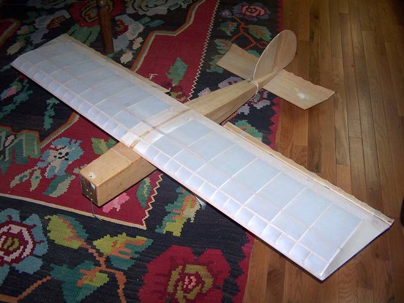

All I need to do for the plane is figure out HOW to paint it (the type of paint + technique) and add the markings (the german crosses). I'm going with him tomorrow to a LHS to see what kind of paint I need to get to paint correctly on a dope fabric. It SHOULD make it stronger and more resilient to common "bumps" and pokes. He says it's a peice of cake (but then again, as I said, he's a MASTER model builder! so how hard it REALLY IS remains to bee seen
As an example, he built a 100% accurate and perfect "The Spirit of St.Louis" in a 22" wingspan that's hanging from the ceiling in my son's room > I'm BOUND AND DETERMINED that this kid WILL be a pilot
RC or "real", I don't care, as long as he shares his old man's unadulterated joy about planes! [sm=wink_smile.gif])
Anyways, with my newly recieved K&B .45 engine (which is in awesome condition, esp for $35!), and my "new" SkySport 4, complete with 4 high torque servos, Transmitter, Reciver (ch48), battery, on/off switch, and connecting cables; even the original manual! (yeah, it's old and discontinued, but for $40, I couldn't pass it up! I really only needed 4 servos, but 4 servos are more than $40!!!!), I'm in some sort of "daze"
. The .45 is slated for the SkyBox Fly40; the servos and controller were too, but I'd rather put them into the Ugly Stik, just to get it flying after TOO LONG on the ground. This bird needs to FLY !!!!!
But I may have to be realistic and I may just hang it from my ceiling for a while until I can rack up more "training" time on a "crashable craft" like the SkyBox that's been banged on more times than HUMANLY possible (it's almost "airplane abuse" what's been done to this poor thing! I've gotten it back together and it WILL fly again; it'll make a great "pracice plane" b/c if I crash it, it won't be the end of the world)
Well, now I'm up to PLANE NUMBER FOUR and I haven't even fully solo'd yet [sm=50_50.gif]. Could it BE possible that I'm getting ahead of myself, or am I just lucky to BE in this position and STOP THINKING OTHERWISE and just GRACIOUSLY accept the free planes

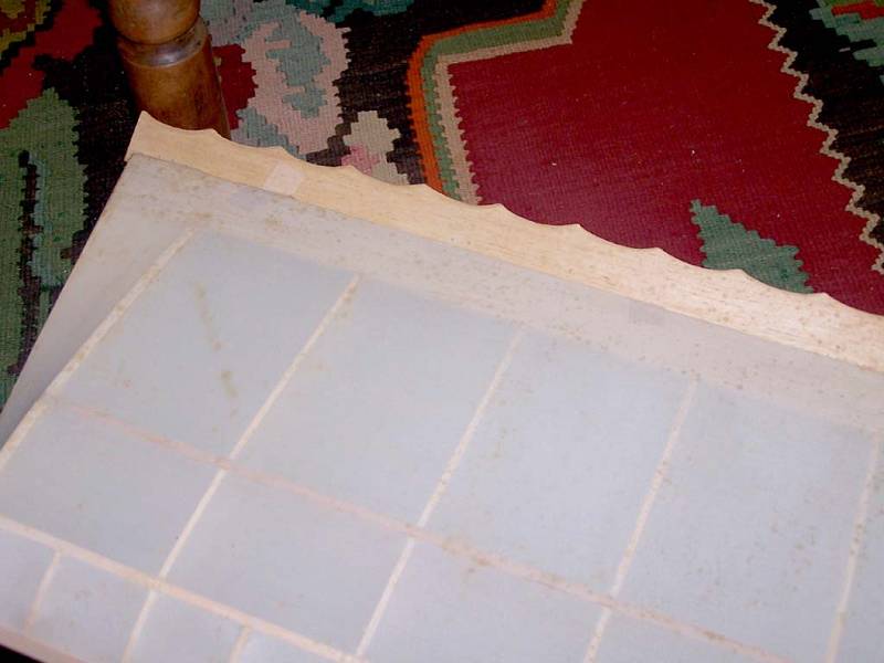

I'm in favor of the latter [sm=angel_smile.gif] I'm including some pictures of my "new baby". I still can't believe it!
(ps the stains on the wing's doped fabric are basically age/mold discoloration from sitting for 10-15 years without being painted; they're purely cosmetic and there are no "holes" eaten in the fabric or even weak spots; I'm telling you this thing is SOLID!

That is a truly beautiful aircraft Spacemonkey!
I have a Great Planes ARF copy of it (Big Stik 40) and it is my favourite plane. I have downloaded plans of an Ugly Stik and plan to scratch build one soon.
Have you ever flown a Stik? If not you are in for a treat. They land as easy as your trainer, refuse to misbehave in a stall and go exactly where you point them.

Do you guys think I should put a .45, .60, or a .90 (all 2 stroke nitro) on it to fly it? The plane weights around 6-7 lbs without the electronics, battery, fuel, engine, or even wheels, so I'm not sure that even a big prop with a high pitch on a .45 would work (like an 11x10 -which is inside the "curve" for a .45-; it's going to have to be nylon to keep the mass of an 11" prop down, but the "10" pitch should really SLICE and pull some air!);
>>>> on the other hand, my Senior Falcon (which he also gave me) wieghs in at just over 9 lbs with the electro-gear and the engine (sans fuel) and it pulls like an OX with a wood 11x8.... If I put a .60 on it, I'd have to either go with a wooden 11x8 (I have 4 of them and I like the way they move & look) or a wooden 12x6 to keep the speed down, but still have some power and "authority" without having it get TOO fast on me.
>>>>> I don't own a .90 (and don't see a time in the near future when I "could" get one either....) just out of curiosity, what's a decent quality -not GREAT quality, just "decent"- .90 size 2 stroke engine? I know NOTHING about 2 strokes past the .60's..... I know a .90 will THROW that sucker through the air, but I don't want it to get away from me at the speed of sound and wind up with a "racer" plane that's WAY too fast and powerful for my abilities..... [
I do know 2 things right now (1) it's a beautiful plane that's going to look even better when it's fully decked out in German Red with Maltese Crosses and (2) I'm BEYOND lucky and don't want to "waste" a hand made plane due to GROSS incompetance!!!! (3) I can hardly wait

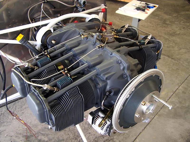

(here's a couple of pics of his "real" plane -> you can obviously see he, how shall I put this.. "good with details"
that's why the build of the Sr Falcon and the Stik is so danged PERFECT!)

The plane he's building is an RV-9A http://www.vansaircraft.com/public/rv-9int.htm he's building a 2 seater, "side-by-side" model. His neighbor has completed one(with front-to-back seating). Including my father-in-law's RV-9A, there will be FOUR "RV-9" series planes at that particular field. One of the guys at the field/housing community with one that is MAXIMUM built and flies passenger jets for a living now, but is a former Airforce Aerobatics Instructor..... the other day he was making passes about 15'-20' off the runway at 250mph (i heard him over the radio confirm the speed) and then pull it almost STRAIGHT UP to 400-500 ft -> he says he pulls between 6-8g's "typically" when he's just "messing around", but when he's "serious" he'll push it to ~9... [X(] He then flicks it into a BEAUTY of an Immelman, just like he was going around the corner to pick up some milk
It's one thing to see it in an RC, it's another ENTIRE thing to see it when there's a PERSON INSIDE
Now that I'm home from TN, I've been doing some measuring of the new Ugly Stik; it's got a 60"ws and a 46" length (tip of the nose to the tip of the rudder). According to Great Planes, using THEIR sizes, this would put it in the .40 size range. Doc was planning on putting a .90 on this thing! He thinks a .60 is about right and probably the "smallest" he'd go. What are your thoughts on this? Just remember that the ENTIRE fuselage, hoizontal and vert stab are ALL SOLID THICK balsa sheets (no "skeleton" cutouts or anything, this sucker is SOLID!). The wing is covered with.... (nope, not tissue!)..... with "silron"! It's a silk+rayon material that hasn't been around for a while and IF you happen to run across some, it's worth it's weight in GOLD! Plenty of vintage model aircraft builders will give up a kidney for a roll of this stuff. Like I said, my Ugly Stik was built from blueprints about 30 years ago -i've got the original prints, so I have to be VERY VERY CAREFUL with it -> if I crash it I'm HOSED! because I have NO clue how to fix this thing [:@] much less what to use
because "silron" has been gone for OVER 20 years! Do you guys think I should go with a .60 size or try a smaller .45 I have with a higher pitch prop? I'm leaning towards A .60 with a low pitch prop (11x6)strictly because of the weight of the completed plane and if I WANT it to SCREAM through the air, I can always increase the pitch (to 11x10) and it IS made to be a semi-aerobatic plane..... hmmmm..... [8D]
Doc doesn't fly RC anymore and hasn't in at least 25+ years (the engine I took out of the Hirobo Shuttle I got from him was discontinued in 1982! [X(] ). And he wasn't a very good pilot when he DID fly either
That's why the Senior Falcon is on it's THIRD wing. I know Doc, and he can fix darned near ANYTHING, so that means that he SMASHED this plane's wing SO BADLY that it was UTTERLY DESTROYED to the point of completely "unsalvageable" replacement - TWICE!!!!! [:@] and that's a gigantic "WOW!!!!" revelation to me! He'll see the Falcon AND the Stik fly! I promised him that!!!
It's going to take some work to finish the Stik, I'm going to have to put 2 layers of clear dope on the wing, THEN 3-4 coats of RED and WHITE dope paint. Then 1 more coat of clear to seal the paint + decals. That takes care of the wing.... The body on the other hand is going to take a little more work.... First 2-3 layers of clear dope on the balsa, then ultra fine sandpaper to smooth it down, THEN I need to put 1 layer of tissue over it and clear dope that down. Then sand again. Then 2-3 more coats of clear (the idea is to "fill in" all the little holes, grooves, and grains of the balsa and make the surface GLASS smooth). Then 2-3 layers of RED and WHITE dope paint, then decals. Then 2-3 more coats of clear to seal it all down. Between 10 and 13 layers of dope and paint combined!!! [X(] Oh, then of course, I have to put in a servo tray, battery holder, kill switch, install control horns on the rudder, elevator, and ailerons, attach the wheels, etc.... there's a few more than a "few" hours to be spent on it
Btw, does ANYONE know where I can buy "maltese cross" decals for this?
I know this sounds INSANE - I thought so too when Doc was telling me all this - but then I started looking at the Falcon's fuselage. It LOOKS LIKE FIBERGLASS it's so smooth and glossy! It's VERY, VERY impressive to see up close so I can see WHY all the clear dope needs to go on. The shine/luster is really one-of-a-kind and dang sure doesn't look like ANYTHING you see in even the best of the ARF's! All those layers also have the bonus of adding strength to the balsa framework so busting it up shouldn't be as easy
(i'm emphasizing "shouldn't" very heavily....) It could also explain why the Falcon weighs in at between 9.5-10 lbs (without fuel!) too!!!
There's already a few small holes punched in the silron that I'm not sure how to patch.... I think I may just use small pieces of tissue to cover them with the clear dope. (they're very, very small holes; the material is OLD - so old that it's actually yellowed in some parts, but it's not brittle, THANK GOD! just a little "splotchy" looking...)

I do not think you will be at all happy with a 45 on the Stick.
I have the GP Big Stik 60 with OS 91 four stroke. It weighs about 7.5 pounds. The plane has excellent performance but is definitely NOT overpowered.
Since you wrote that you already have a 60 size two stroke, that's what I think you should use. I have an ASP 61 two stroke on an Uproar 60, which weighs over 7 pounds, and it performs well using a 12x6 prop.

If you want 2 stroke go with an OS 61, cheap,reliable powerful,and probably enough weight for correct CG, or a 91 OS /Saito four stroke.Dont cheap out on the engine and splinter this classic.

carrellh, I think you're right. Because of all the dope that's going to be put on it to give it a REALLY nice gloss, a .45 even with a 11x8 prop is going to really underpower it badly b/c of it's weight. I've got an OS .60 that will fit well on it and I KNOW it will pull it through the air VERY well (my Sr. Falcon runs a .61, 11x8 and it weighs 9.5-10 lbs w/o fuel!). And thanks for the links to the Decals! VERY COOL!!!! I'll have to check the blueprints to find out what sizes I need.
Gray, The fuse + tail is, at the moment, straight, naked balsa planks; no "skeleton cutouts" or anything. It's SOLID balsa! Just sanded alot, that's all. And it's been sitting for THIRTY YEARS!

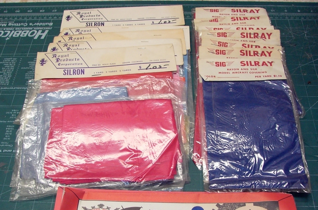

The wing has a "Silron" skin that's drum tight (silron is an OLD fabric material made by Royal about 20+ years ago that's a mix of silk + rayon). I almost WISH it was fiberglassed! I've worked with Fiberglass before, but Silron is a REALLY different beastie all together! And using dope is DANGEROUS! All of it is LETHAL and a Carcinogen, which means working outdoors is MANDATORY
The entire plane will have 10-13 coats of Sig LiteCoat butyl clear dope + 2-4 layers of Red and White glossy Sig dope paint (with 2-3 more coats of clear on top of that). The body will have a layer of tissue on it after 3-4 coats of "clear") followed by fine sanding, followed by more clear, then paint (red + white) + decals; then 2-3 more coats of "clear"
All of the clear dope will give it a really glossy luster (and add weight to it). I expect that after all the coatings, engine, servos, batteries, wheels etc.... it's going to weigh in aroung 8-9 lbs. I'm a little scared to put a 12" prop on it, I don't think it's got enough ground clearance to keep me from banging a prop on landing.... I'll probably start with an 11x7/11x8 and then if I need more, I'll go with an 11x10.
My Senior Falcon has had this same technique done to it (solid balsa with layer upon layer of clear dope + paint) and it's really glossy and looks really nice. It's just going to take some real work to make it look good. BUT IT WILL BE WORTH IT!!!!!!

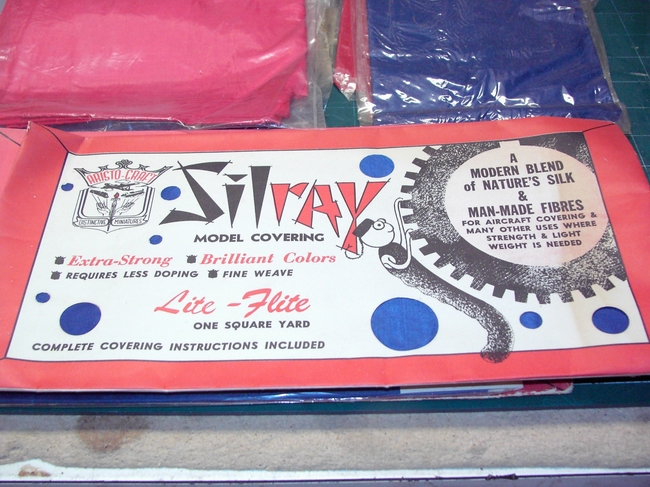

because "silron" has been gone for OVER 20 years! Do you guys think I should go with a .60 size or try a smaller .45 11x10)
because "silron" has been gone for OVER 20 years! Do you guys think I should go with a .60 size or try a smaller .45 11x10) Royal Silron, Sig Silray and Aristocraft Silray worth a fortune huh, Naw I don't need no Kidney especially a used one!

Well TedMo, I appreciate the advice and I know there are plenty of planes that are better than an old Das Ugly Stik; but this one was hand made by my father-in-law, 30 years ago, and has been just WAITING to fly all these years. It makes it a special kind of "mission" to get this plane in the air for me. Kind of a "quest" issue
I know the dope + dope paint is going to add alot of weight. The 1st plane he gave me is a Senior Falcon, 1970's era. It's also a solid balsa construction with 10-12 coats of dope, paper, and dope paint on it. Granted, by buddy calls it "the Lead Sled" because it DOES weigh in pretty high! (between 9.5-10 lbs), but it's beautiful and VERY SOLID
, but a Webra 10ccm (.61ci) w/ 11x8 pulls it through the air with NO problems at all. It's around 1.5x the weight of my Tower 60 (at 6 lbs) and 2x the weight of the little SkyBox Fly40 (at 5 lbs) I have. I'm not worried about the weight (right now it weighs 3 lbs; after the servos, engine, battery, fuel tank, wheels, and dope coats, I'm expecting it to weigh in around 9 lbs - that's REALLY not that heavy on a plane with such a wide chord and huge washouts); it may fly a little "dense", but its control surfaces have some "authority" to them to put it mildly
>> the elevator and rudder on those Stiks are HUGE! and the ailerons are 2.5" wide each. It WILL fly, come hell-or-highwater, it's just going to take ALOT of work and ALOT of smelly goey dope.
I promised him when he gave it to me that it WOULD fly; given the fact that he GAVE me this beauty and he HAND CRAFTED IT straight from blueprints; cutting and shaping EVERY part of it (you should see the PERFECT shape of the wing! The washouts are PERFECT, it's solid as a rock, and even the Silron is still tight as a drum - literally!), it would be a crying shame, and almost disrespectful to him to "museum" this craft. It might take a little while to get it done, but it WILL fly
in the words of an airforce general when asked about the, then new, F4-Phantom, "The F4 is living proof, that if you strap enough engines to a brick, it too can fly"
Also, I'm flat broke, so ANY plane I get, I HAVE to fly! I, unfortunately, don't have the luxury of going out and buying even a cheap ARF, so free plane = FREE PLANE
and that means FREE FLYING! My "hand made" planes may weigh a ton, but they're one of a kind, and they fly (or will fly), and I like them ORDERS OF MAGNITUDE more than my Tower 60 and the SkyBox Fly40 (or for that matter MANY ARF's I've seen; even the GP Big Stik). The hand made ones are more durable, more attractive, and MOST IMPORTANTLY, they were FREE
