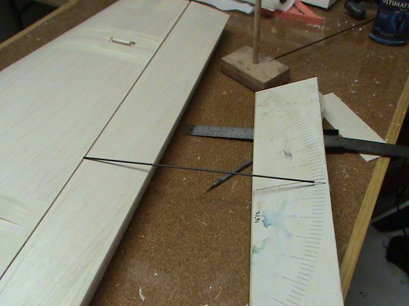

Default RE: control throw setting ? home made tool ?
Yes, a very accurate one too. Much better than anything I’ve see you can buy. You'll never go back to a ruler. It is simply degrees drawn out on a board for a gauge, the board mounts to an adjustable stand, and a pointer is taped to the control surface. I used autocad to make the degree scale on the gauge, but you could take a protractor and copy/enlarge it to whatever size you want if you don’t have cad or similar. The key thing to record is the radius of the arc. Make a pointer stick that length. I use carbon rod with a pin glued to the end. Make a stand however you want. I used a dowel in a base and then have an adjustable fitting with a thumbscrew to attach and rotate the gauge. To use, tape the pointer stick to the control surface as close to the hinge line as you can. Move in your stand and gauge and adjust it so it reads zero and the gauge is perpendicular to the pointer (importnat!) Presto. A degree scale that is very accurate. Mine uses a 16.5†radius and I can easily resolve to 1/5 of a degree. You’d be surprised how much better planes fly when the control surfaces really are matched. Hope the pics are understandable, I have a project on my building table and couldn’t really set up the gauge properly, but I think you get the general idea. If not, post questions and I’ll try to respond.
Yes I do, mater of fact I have several made up right now, both left and right. I haven't used A ruler or that funkey thing Tower sells in years. They are however A bit smaller then John's. Today I set up the controls on my rebuilt Kaos and all my controls are even and all set to the same exact throws. Takes no time at all. If you need photos I can take some tomorrow.

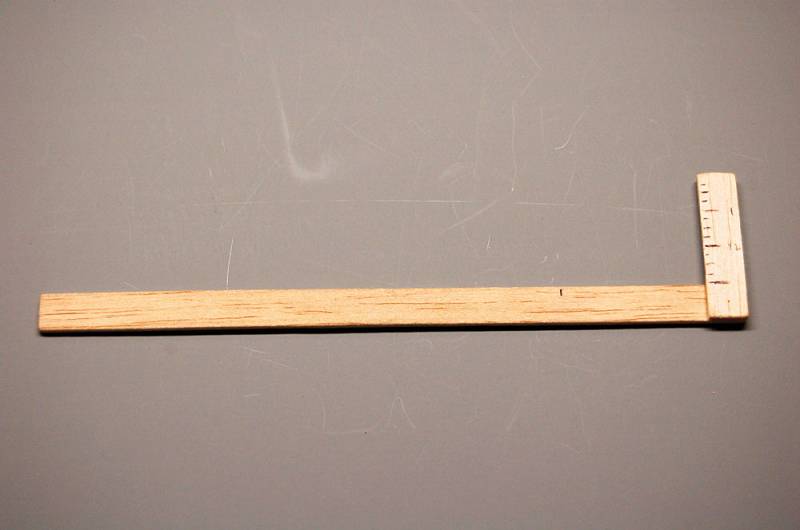

Old 09-12-2008 | 09:53 PM
Posts: 2,065
From: Philadelphia, PA
This costs nothing to make and is so easy to use I rarely go looking for the fancier throw guages.
Sorry, the weather is just too nice, been out flying. I have some of the degree wheels from C&H ignitions that they give you and make up copies on my puter using photo paper and in different sizes. You can use whatever you can find or get ahold of. Just made from scrap light ply and some of that plastic control rods with A little weight stuck on them. I have given them to people and they have put soft rubber on the bottoms for some added grip on the covering. My wire is dental wire that I had left over but I have gotten piano wire at the hobby shop and used that too. I used to sell them at clubs and events for 10 bucks apiece some years ago. For stunt or 3-D planes I set the controls at 18 degrees high and 12 degrees low, rudder always as much as I can get. For sport planes I set the throws at 10 or 12 high and about 8 low. Using gauges you can have everything centered and throwing the exact same distance. You can watch the gauges when you are setting things up in your sub trim. Just makes set up way too easy.
