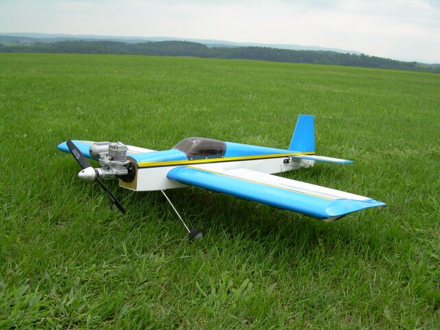

I have a Mini Magic Extra ARF. From what I can remember, it went together like most other ARFs. Is this your first ARF build? If so, this is not a beginner airplane. If you have specific questions about the assembly, I can try to answer them (I assembled mine a couple of years ago). From what I remember, the control rods were junk, I bent my own out of music wire. The engine mount sucked too, I used my own. I actually mounted an OS .25 FX on mine, it's a real screamer, but have to limit flights to 5 mins due to the tiny fuel tank. Not much room to put in a larger tank either. The photo below is before I shoehorned the cowl on over the .25.

Now that Redback mentioned radio placement, you'll notice this plane has an access panel in the tail of the fueslage. I actually put my battery and receiver back there to balance mine out. As I said, I put a .25 size engine in mine, so depending on the power system you choose, you may or may not want to consider putting the RX & batt back there.
I also put on larger diameter wheels than what came with the ARF to roll better on grass airfields. I used narrow, light-weight plastic wheels that Maxx Products makes for electric planes.
