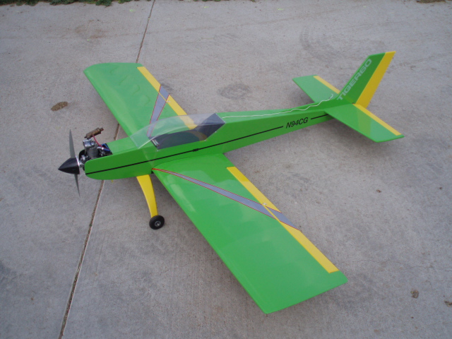

http://www3.towerhobbies.com/cgi-bin...?&I=LXFV47&P=0 http://www3.towerhobbies.com/cgi-bin...?&I=LXHBP8&P=0 these are the ones I used on mine. You just have to renforce the fuse with some ply and some blind nuts before useing them. I like the rudder control link. Our runway is a little bumpy so having this makes it nice.

I did exactly the same mount on an old Goldberg Chipmunk whose gear ripped out of the wing. Re-enforce the fuselage bottom with another layer of plywood (at least ÂĽ-inch) and glue it in with triangle stock up the sides of the fuselage.
I would also suggest you go with nylon bolts (http://www3.towerhobbies.com/cgi-bin...?&I=LXK194&P=7). With #10-size, I would mount the gear with 3 bolts. That way, the gear will “break away” with a rough landing instead of ripping the bottom out of the fuselage.
This setup “worked as advertised” when I was horsing around and overshot the Chipmunk into the rough field beside our runway…[X(]
Edited: I forgot that I drilled and tapped right through the fuselage bottom (lite ply) and into the 1/4-inch hard plywood. Then hardened the threads with thin CA and ran the tap through again after it dries. If you break off the nylon screws, they are easy to drill out using a screw removal tool or if you can grab the other end, just thread them back...

I built mine (from the kit) for my son in the tail dragger conversion, Sullivan tail wheel. But I used this main gear so I could paint it, and it helped with my son's semi-rough landings. I say "helped", because he can just about grease the landings every time, KOW! He even had a beautiful dead stick (dad leaned out the motor too much[X(]) landing a few weeks ago. Just a great plane for him. http://www3.towerhobbies.com/cgi-bin...?&I=LXNM65&P=0
Just saw your plane in the crash and rebuild. That's an easy fix, and if you need help with the tail dragger conversion, just ask, these guys have really helped me a lot.
