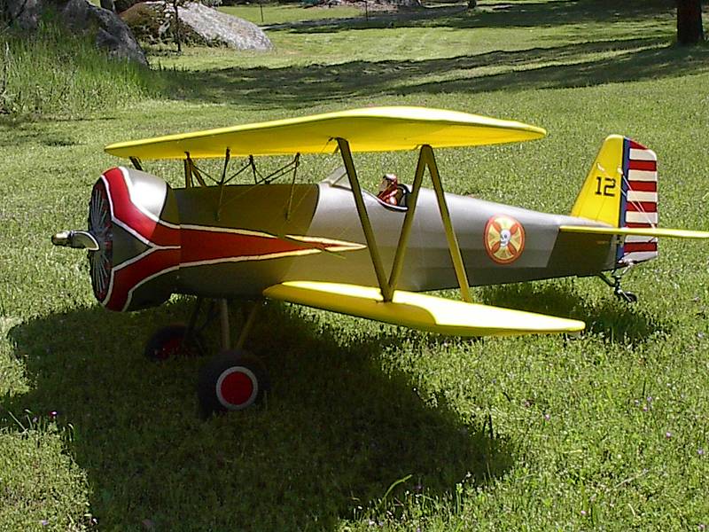

Default RE: Suggestion for Beginning Builders
You do know that Solartex comes in A lot of different colors plus it takes to paint very well? An old scratch built Boeing F4B-2 in Army colors, Navy colors were just silver and yellow but the same plane.
ID:	1048323   Click image for larger version
