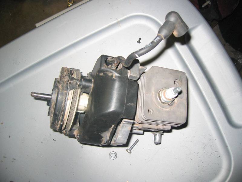

It has been a long time since i have been in the hobby, but this leaf blower motor has got my mind a spinning. the side blew out on it and now i want to use it to power my model airplane. it is a 25CC 2 cycle motor and I have a few questions i am unable to answer myself.
1st. i plan on building a j-3 cub style aircraft for it completely from scratch. now i will be able to do this without much difficulty, but i need to know how big to build it. i don't plan on doing more than lazily flying it around, and it would be nice if i could put floats and skis on it without it wanting to fall out of the sky.
2nd. I want some opinions about whether to leave on the pull start. it would be nice to leave it on and just be able to pull start the airplane, but at the same time i know that is a decent amount of wait at the extreme front of the airplane. I just feel it would be more convienent to have it on there so i don't have to drag around my starter.
3rd. I have heard of people having problems with radio interference with these 25cc conversion motors. is there anyway to test if i will have this before i take the plunge into flight??? are there ways to reduce the radio interference?
4th. has anyone done this before with a Sam's club leaf blower. it is a propol leaf blower. worked good for 4 seasons untill the side of the impeller chamber blew out. the motor has always run like a champ, but i was curious if anyone had used this particular motor before for a conversion.
5th. and i know this will create some debate. what kind of prop should i use. i would like to use a 3 blade prop as i have never used one before, but if enough people recommend the slandered 2 i will use that instead. also what kind of pitch should i use.
and lastly. should i try and build a new muffler for it or can I adapt the one that came with it. this is the only part of the motor that i'm iffy about. it was used for several seasons, but this is the only thing showing it's age the rest will clean up nicely.
Any help you could give would be greatly appreciated. below are photos of it, also i don't know how much it weighs right now.

First let me say welcome back to the hobby and welcome to RCU!
1) I would plan on a 1/4 scale cub. I would also recommend building a clipped-wing version . A clipped-wing Cub flies just as gentile as a full-wing version, but frankly, the full-size wing is too big. It was designed around an engine that was barely big enough to get the plane off the ground and due to it's length, it makes turning difficult (Lots of adverse yaw).
2) Take the pull-start off. It would be nice to pull-start it, but as you said, it's excessive weight - not to mention the fact that it would be impractical (Where would the handle be sticking out?) and it would be very difficult to conceal under a cowl.
3) Keep your radio at least 12 inches from the engine and use a non-metallic pushrod for throttle.
4) I have not used this particular engine, but I have converted weed wacker engines and they work great.
5) Gassers have a pretty wide range of props. You COULD use a 3-blade, but it wouldn't look very scale, and 3-bladed props lose some efficiency, I would try something like a 16x8 2-blade
6) That muffler should work just fine.

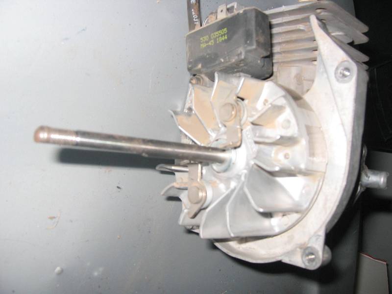

No need to forge a new mount. Just grind off those two things on the side of the back plate and attach a 1/4" aluminum plate with the 4 existing bolts (Of course, you may need to replace the bolts with longer ones due to the thickness of the plate).
A hole in the center of the plate will allow whatever that is in the middle of the back plate to protrude.

You need to remove the pull start. Imagine that thing kicking back and pulling your hand right into the prop. Plus, what if it starts, and you let go of the rope, then the rope ends up lashing into the prop disc...just dangerous.
1/4 scale is just right for that sized engine. Maybe a 90 to 100 inch wing????
Also, I wouldn't use a 3 bladed prop on a cub.....it would just not look right.
you need to machine a lot of the extra weight off of the engine. Shave the flywheel down-take off the cooling fins. Also, shave down some of the cooling fins on the head itself. Get a free-flowing header, or make one from aluminum stock. You'll have to have a prop driver machined for the engine as well.
All in all, I would think the afore mentioned 150 dollar 25 CC with EI is a better deal, unless you are just wanting to tinker with this thing. I would guess you'll have at least 100 bucks tied up in the conversion in both cash and time.
