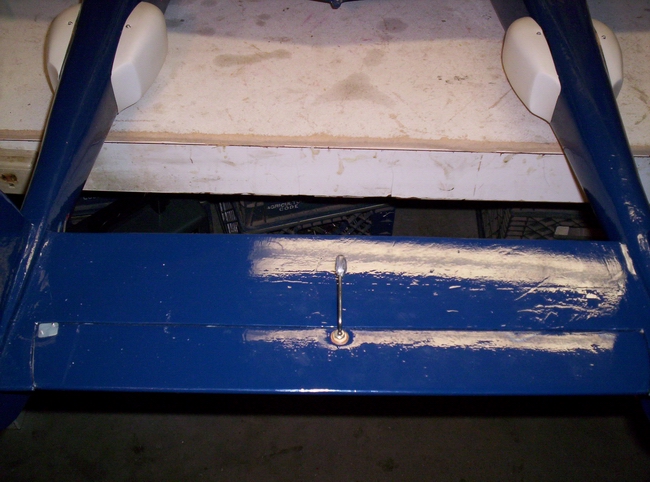

ORIGINAL: freakingfast
Just too much work to fix so I pulled off the gear and sold it. I put my efforts elsewhere.
Actually when all else fails what will work every time are these, simple to make and simple to install:
ID:	1443100   Click image for larger version
ID:	1443101   Click image for larger version
ID:	1443102   Click image for larger version
ID:	1443103   Click image for larger version

The balancers (counterweights) are what I thought of, too. But if you only get flutter in a full-power dive you have a fine set-up already. Some models will tear themselves up at full throttle in straight & level flight (overpowered 3-D models, for instance). My Ultimates and my Hot Stik could shred control surfaces at full-power in level flight. Avoid full-powered dives. "Real" aircraft do.
Old 05-27-2010 | 12:16 AM
JohnBuckner's Avatar
Posts: 10,441
Received 11 Likes on 11 Posts
From: Kingman, AZ
Default RE: Flutter on Skyraider mach 2!
Mass Balances do work and I have never found a case where they would not regardless of power or velocitys. Mass balances simply move the onset of flutter beyond any speed the airplane is capable of ever reaching at any power or dive angle.
I was in the habit of making up bunchs of them to take to the old SWRA warbird races Here in the southwest and later in RC Pro warbird races. Flutter issues were/are common at these events and in most cases it tended to be the ailerons, especially with strip ailerons.
When one of the fellows survived an episode of severe flutter (meaning extremely obvious) I just shared a pair and all he needed to do was go poke a hole in his ailerons and he was good to go for his remaining rounds, works every time.
