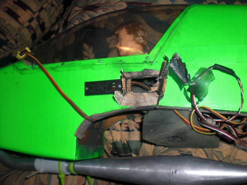

I was preparing for tomorrow charging all my batteries, and after i was done charging battery #1 , i heard a startling pop. it is a NIMH 2000 mah battery pack i was using my triton jr set at 1 amp to fast charge. The "explosion" happened about an hour after i was done charging

Was it on trickle charge?? If so, that is probably what kicked it off. NiMh keep trying to take a charge on trickle and will overcharge. You can feel them start to get really hot. I've cooked a couple by not catching them soon enough.

Charging at 1 Amp is a bit excessive. I'll bet that batt was really hot before the explosion.
Charge a little slower and show your batteries some mercy.

I keep hearing these kind of stories at the field of folks cooking their batterys with their expensive chargers all the while talking about always fast charging their batterys. Good heavens give your batteries a break, C10 for 2 thousands is 200Mah

Yeah i think i'll ease up on the charging ... the reason i fast charged last night is because whenever i charge at the rate i'm supposed to on my triton jr(.1-.2), it "times out" before its fully charged..... Its the old model of the triton jr, that doesnt let you disable that feature
What is your time limit?
Consider this:
First off you are not completely dischrging your battery to begin with so you won't need anywhere near 2000mah of replacement charge. I bet 1500mah probably would be close.
Divide that by your time limit (in hours) and see what rate you really need.
Another thing about fast charging NiMh on a peak charger is you can get a false peak and really not be near a full charge.

i believe it times out after an hour 1.5-2.0 hours

Any charger that will not allow normal C10 charging for the capacitys you are using is a fast charger only and in my opinion should only be used infrequently. Fast charging agine in my opinion all three of the battery technologies we normally use causes heat (sometimes to the extreme) will result at best in shortening service life. At worst it can and will cause well what happened to you.
If money is an issue tower sells 200 Mah wallworts that would work well with your 2000Mah batteries. Or there are hundreds of remarkable chargers avaliable now for cheap that are fully peak detecting and fully selectable for the normal capacity batteries we use.

I have seen several NiMH packs blow. The lecky boys like to get them hot just before launch to get max power. When they exceed the critical temp they do go bang!
I stay with 1/4 C as my max charge rate on NiMH cells.

i found out that charging at 1 amp(1000mah) all the time is bad for my 2000 mah nimh packs. That explains why ive killed two nice battery packs, one by explosion, and the other just lost a cell.

IMHO fast charging is just a bad thing, I use the Accu-cycle and charge my 2000's at .125 for the cycle time of 15 hours., this is only after I discharge. Also it was mentioned that most of the time you will never use more than 1/3 of your large pack, keep this in mind when charging, in that case I put it on .050 setting and let it go overnight, similar to a wall wart. 12 hours on a WW is the same as 600 Mah or 12 times the output rating on your charger.
Think about your 1 amp rate for 2 hours, 2000 Mah for a pack that only needed 500.[X(][X(] hence the explosion.
