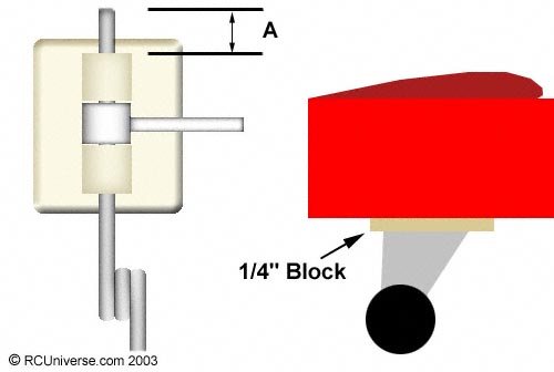

Hello all. I'd like to put a bigger foam wheel on my Superstar 40 trainer. The 10 x 5 on my OS 40 LA is about 2.5 inches off the ground, which means I mow a lot of grass with my prop unless the grass is freshly cut.
My question is, can I just put a bigger nose wheel on? Or must I change all three? My concern was that with a larger nose wheel only, the angle of the fuselage will change (i.e. the angle of attack will be more like a tail dragger).
Does this matter? NOTE: current wheel dia. is 2.5"
How about a 3.5"?
Paul
How about a 3.5"?
Paul

First off, remember that the size of the wheel is the diameter. ie going from a 2.5" to a 3" maybe 1/2" up in diameter but it will only give you 1/4" extra clearance.
Another option which may give you more height is to simply bend the landing gear. The main gear on the Superstar is probably quite wide and could be bent in a little for more height. bend both ends to keep the wheels perpendicular. Then you should also be able to adjust the height of the nose leg also.
I don't recommend putting the plane in a nose high attitude. When I put my LT-40 together I had to use a nose leg from elsewhere as the original wouldn't fit. The replacement is a bit longer resulting in a slight nose high attitude. I'm finding that when landing, I have to keep the nose up to for a proper 3 pointer. This makes it tricky to keep the plane down when you're still carrying some airspeed.
BTW I've also got about 2.5" clearance. The length of the grass isn't the problem, its that the runway is a bit bumpy it could either be the unevenness of the ground or the spring in the nose gear causing the prop to hit.
Alos, if you're going to change wheels, don't use foam wheels, go for the ruber type, they last longer, look better and don't loose their "round" form when left onthe floor for the winter

Yes, going from a 2.5" to a 3" wheel only raises the axel by 1/4", but it makes a huge difference in rolling though tall grass.
Also, as I said before, nose high is only good for tall grass, on nicely cut grass or pavement, I agree with you. Beleive me, bouncing is not something you're going to do on my field right now. Touch and goes are an iffy thing unless you cary enough speed to risk pulling the gear off the plane, or manage to do more of a bounce and go at just the right point on the field.
When I say tall, I mean grass that is deep enough that the stock wheels on LT-40 arf kits are not visible when the plane is sitting still. It looks like the plane is sitting on wire legs on the taxi way. The shortest part of the runway is only marginally shorter. This is not normal for around here, we have had a spring that is just making the grass grow like crazy.

Originally posted by MinnFlyer
To go from a 2.5 wheel to a 3" wheel will give you 1/4" more height (3 - 2.5 = .5 /2 = .25). Instead of buying new wheels, see if you can extend your nose wheel by 1/4" and add a 1/4" block between your main gear and the fuse.
If you don't have any extra wire at dimension "A" below, there's not much you can do I guess, As far as the block goes, this is what I was referring to:
