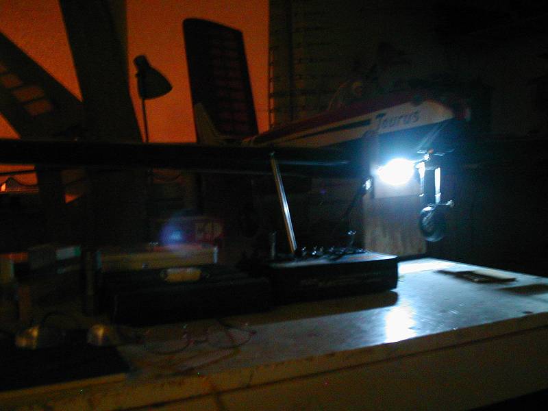

I do fly under all weather conditions and often alone, especially in winter it's very important to have a reliable engine and equipment.
When you lost the plane outside the field it's possible you cannot find it back because its dark, that's the reason I also have a spotlight in the flight direction to land the plane.

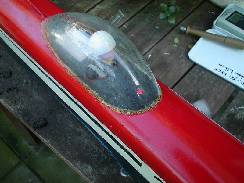

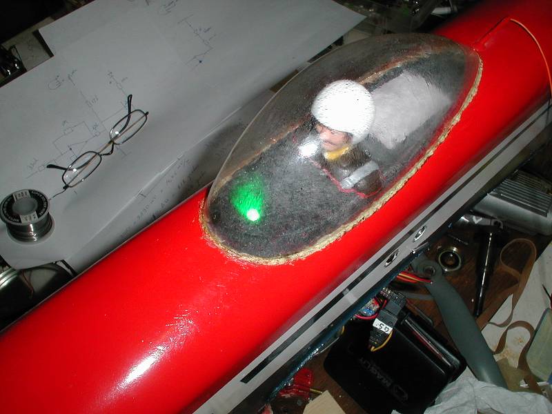

(It's bad visible on the picture of the other post, so I add some more.)
All the electronics of the Taurus have a seperate battery for safety reasons!
