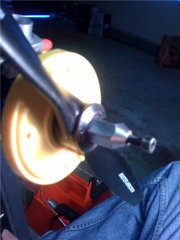

Ok i cant figure out how to attach my prop it just slips and doesnt catch on to the engine picture included I am useing a durabo spinner..
Right now it is backplate, prop, prop washer, nut, bolt, cone... Thanks!
Andrew

ORIGINAL: andrewtexas123
Andrew
The prop nut you are using looks like it from an aluminum spinner setup. It could be that it is bottoming out on the crankshaft threads and therefor not putting any clamping force on the prop. You don't need that nut for your Dubro plastic spinner anyhow. I'd just use the original nut and washer that came with the engine. If you don't have that nut and washer, you can easily get replacements: http://www3.towerhobbies.com/cgi-bin...?&I=LXCP11&P=Z The link if for the .91 4-stroke nut and washer but it is the same 5/16-24 thread as the .65-LA and will work fine. (I didn't see a specific replacement nut for your particular engine)

Any configuration I can do with out buy sh*t? Need to have it ready tommorrow
Its not bottoming out theres plenty of room to tighten it is just the motor turns over when I try to tighten it all the way theres no where to grip it with out tightening it..

generally speaking, one side of the prop is all you need to grab to start tighten the nut, as ChuckW mentioned the nut that you are using is not the apprpiate for this setup.
The shaft of your engine should have a threaded portion and an unthreaded portion just where the flywheel meets the shaft. Your dubro backplate spinner should sit flush with the flywheel, there are some dents at the flywheel as well as the backplate spinner and that is enough to avoid the engine from turning when you are tighten the nut.
I would change the nut and try to find the right one.

Did you buy your engine new, or was it part of a package deal? If you got it new you should have the washer and nut shown in the picture and you should use it instead of the spinner adapter that we've seen in the pictures you have posted. If you do not have the original washer and nut, you have to try to deal with what you have.
All of the pictures you have posted show a socket head screw in the spinner adapter nut. Since you wrote that you have a Dubro nylon spinner you need to take the socket head screw out and put it in your toolbox.
I sort of hate to suggest this, but you may need to use pliers to keep the engine from turning while you get the prop snug. Once it is snug, friction should hold everything still while you really tighten it.

Take out the allen head screw from the adapter nut. It looks like it is in too far and hitting the crankshaft thus not allowing the nut to seat properly. Based upon your post, it seems that the help off an experienced pilot/builder/engine guru onsite to help would be your best bet if possible. They would be able to show you how to setup everything correctly. They should be able to show you how to balance your prop correctly as well. MAS props are rarley ever balanced right out of the bag.

Hi Andrew , It is possible that you could have the wrong spinner adaptor and the eng of your crankshaft is screwed all the way in and is bottoming out againt's the spinner adaptor nut. I have had that happen before. The other possiblity is you have the allen screw too far in , you need to remove the allen screw at this point to find out if the crankshaft is bottoming out again't the back side of the spinner adaptor nut. If it will tighten up then, you might have to shorten the allen screw if it too long. Hope that helps you.

It ended up being a never useing glow motor/prop mistake wasny sure how to tighten but you have to hold the prop. I wasnt sure one of the guys at the field fixed it up and I have flown 3 tanks on it so far and idled 1/4th of a tank today (At the house) just to get used to the starting of a glow motor! Started right up no problems!
