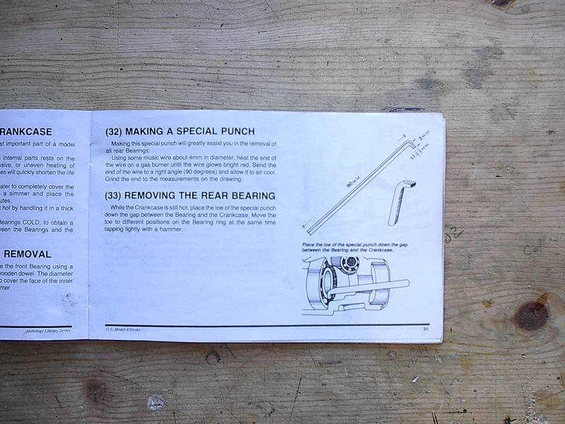

I bought this little book from RCM years ago, not A lot has changed in any of the four strokes over the years and I think you can still get this book, there may be better ones on the market today?? I have A big pot and A hot plate out in my shop, I just drop the case into boiling water until hot then use my way cool home made bearing knocker outer to remove the rear bearing. Works every time.

Is there any way you can get in behind the outer race? Like say with a special tool made out of a narrow flat bladed screwdriver with the tip bent 90 * and ground thin? (know what I mean? )
Similar to the pic in Greybeards post #3 but go in through the backplate opening? Is there anything (any "lip" ) to catch on? You'd still need to use heat...and leather gloves of course.

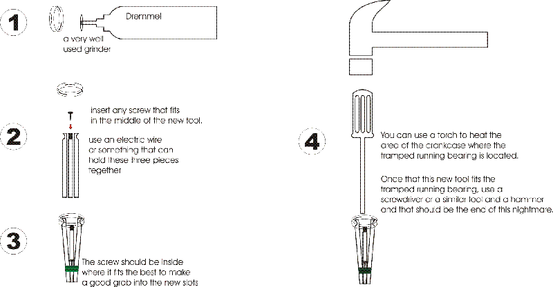

This could be of help:
The three pieces needed to make this tool can be obtained from used small screwdrivers or hard wire from older landing gear.
Good luck!!

Make your tool out of piano wire and do your bend without heat. Then cut it and grind to shape like shown in the photo. That little home made tool can be used as A pusher or puller, A tap on-er or A yank on-er. Using heat to bend it takes out the temper. All you need to do is lip hook it.

ok guys..question....am i supposed to simply use the screw as a wedge to tap inbetween these three peices? or do i actually screw the screw down inbetween them? ive made this tool you guys have shown me but when i turn the screw to wedge and expand the three peices to press against the ring and lip....the 3 peices keep spinning and turning out from catching the lip. haha man and ive tried to tap the screw in as a wedge but it just goes to one side or the other....cant get it to stay inbetween the 3 peices. i got a grab ONE time, and when i went to tap it out...the tool just popped off the lip. :::ulling hair out:::: WHAT AM I DOING WRONG????

It looks like (in alfred's pic ) that you are supposed to make a deeper groove in the ball groove so the tool will get a better grip?
Do you have a Dremel tool? One of those with a fiberglass reinforced cut-off wheel would work nicely for that operation.
And you use the torch on the outside of the case, keeping away from the bearing race...you don't want to heat that directly.
"Paint" the heat on...waving the torch back and forth, and all around the case to heat it quickly and evenly. Usually a little smoke will start to wisp out of the nooks and crannies...that's when it's good 'n hot...don't go much hotter than that. You don't need more than about a 2" long flame either...no need to really blast it.

ORIGINAL: WingmanEPTX
The screw works as an opener of the three pieces that have grooves to grab the racing bearing which had to be slotted first with a dremmel as the drawing shows. The screw will only work if you join the three pieces with a steel wire or electric wire to maintain these three pieces together. When you hit this new tool with a hammer the three pieces will expand because of the action of the screw which will provide a better grab.
I would use for this purpose an old big piece of wood with a hole that can maintain the crankcase and the tool could go trough the hole.
The slots that you have to do on the racing of the bearings will take some time because of the hardeness of the material, but give it some time, it will work.
Old 11-27-2008 | 01:10 PM
