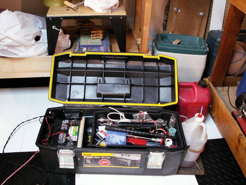

I have 12v ATV or motor cycle battery from Auto Zone. I use a battery charger to charge. I usually charge this battery once every two months or so, and it has a two year guarantee I believe.

I probably swap out my cycle batteries once every three years or so if needed, unless they show signs of wear, then I will usually take them back to Pep Boys or Auto Zone for a simple swap.
