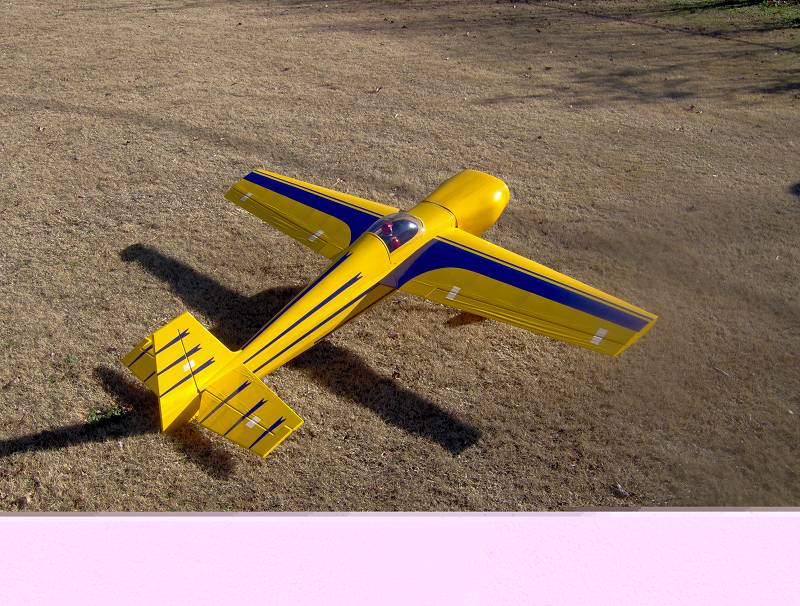

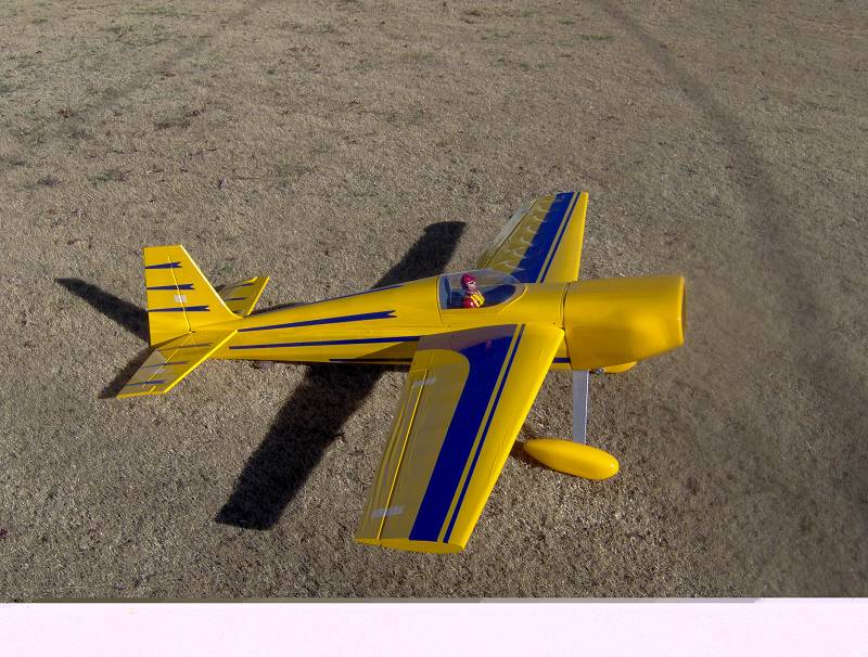

Heres a pic of the laser 120. I did a dry fit to take some pics. I still have to put the decals on and fit the cowl.

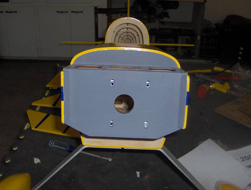

This is a pic of the firewall and the blind nuts. The gas engine I'm useing does not fix those holes. The engine mount screw holes are about a 1/4 inch wider. Any ideas on how to go about mounting this engine? I was thinking about just moving the engine over just a little. the holes are offset to one side so I thought I could just move it back the other way. Will this be ok?

Nothing wrong with popping out the blind nuts, filling the holes and remounting where you need to. I use a hardwood dowl, drill the existing holes out accordingly, and plug away. You could add a piece of ply backing too since you're using a gasser. Then find the best fit that will work for your engine while leaving as much space between the new holes and the repair as you can, though not to worry if they are close.
Not looking at the plane I'm not 100%, but I imagine that the holes are offset to make up for the engine thrust. The engine will be angled to the right a couple of degrees, so to keep the spinner centered in the cowl, they off set the engine.
You want to dry mount your engine on the mount, then dry fit that on the plane to line up with the cowl, otherwise it will look bad. Just do a good job plugging the necessary holes and put the engine where it needs to be. You may only have to plug two holes, maybe all four, depends...
Good Luck!

You can two strips of ply across the back of the firewall over the hole plugs - one strip over two holes, leaving a little extra 'meat' to spread the load. Of course carbon fiber strips are ideal, but I know I don't have that stuff just laying around. Some do though

It looks like they intended you to mount a glow engine sideways...you can mount your gasser at a different angle (upside down?) which would put the mounting holes in a different spot.

ORIGINAL: millertym2000

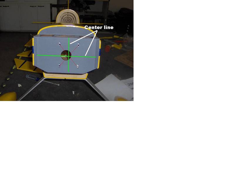

First, I'd use the existing blind nuts to help determine the horizontal and vertical center line of the firewall. This will likely be offset to the left side of the plane to compensate for the right thrust angle. Don't just use the firewall dimensions and use the center of those as a center line since that's may not be how the engine placement is designed. You'll need those center lines as a reference so that you get the gas engine in the right spot to line up with the cowl correctly. Then knock the blind nuts out.
The holes where the blind nuts were can be drilled to a standard size and plugged with hardwood dowel and epoxy.
Can you reach the back side of the firewall pretty easy? Do you have enough access to epoxy a piece of 1/8 or similar plywood? Doing this could help beef up the firewall for the heavier gas engine. You could also sand the front of the firewall down to bare wood and epoxy ply there but make sure that doesn't make the engine stick out too far.
Another precaution might be to pin the firewall. Drill holes through the engine box sides and into the edge of the firewall itself and epoxy some hardwood dowels. This will really help strengthen it.
Some people also like to use fiberglass cloth and epoxy on firewall and engine box joints. It may or may not be necessary on this plane but it probably wouldn't hurt either way.
You might also find some expertise in the gas engine forum on mounting the engine in planes similar to this one.

Here's a sketch of what I mean on the center line. As you can see, I flunked art school.
This is how I would proceed anyhow, there may be other ideas and options out here.

I do plan on useing a CRRC 26cc mounted upside down. I can get to the back of the firewall pretty easy. So I should be able to add a thin piece of ply to it. yes it was made for a glow engine so I will need to drill all new holes. It looked like stickers not trim.

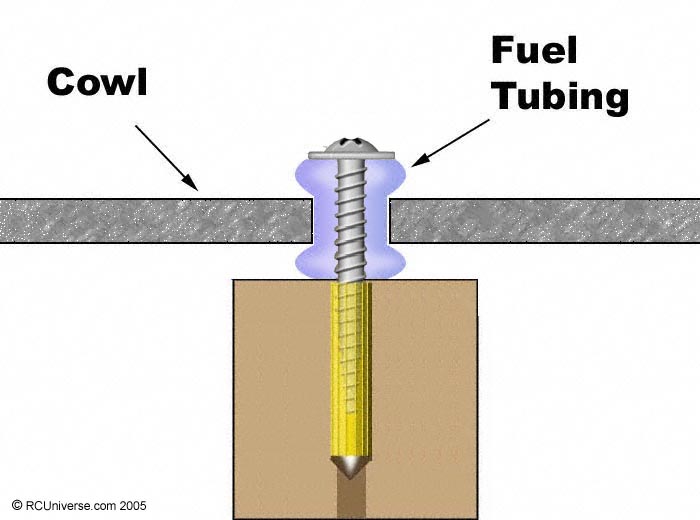

Here's a method to mount the cowl that will protect it from cracking around the screw holes. Use a bit of fuel tubing to make a grommet out of. Drill the hole in the cowl a bit larger than the screw. Then when you tighten the screw it will expand the fuel tubing. This absorbs the shock of vibration from the engine and will keep the cowl from cracking around the screws.

The engine offset should be about 3/8 on a inch. Look and see if the firewall has a built in offset as well if not you will have to shim one side of the engine to bring the prop shaft back to center. Dennis
