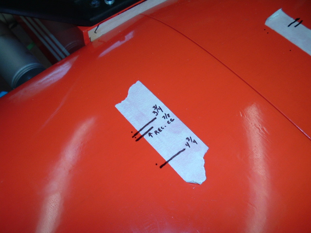

Instead of using your fingers make yourself a quick and easy CG maching. Drill two holes 2"or 3" apart in a 1"x2" so that you can put two pencils in, one in each hole. Now you have can set the plane on the top of the erasers of the penils to find your balance point.

Like dis...

Yes, you balance a low wing with the plane upside down, a high wing plane right side up. I was testing the balance point (cg) on both sides to see what the difference was. I had the plane perfectly balanced on the "pencil powered CG rig" so I could snap the picture. I used a piece of masking tape to get the forward most, rearward most and recommended marked without drawing all over the plane itself. I used new pencils so I didn't have to accommodate a point on the end that went into the board.
