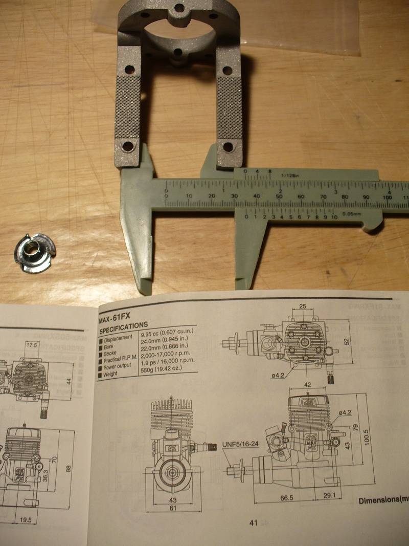

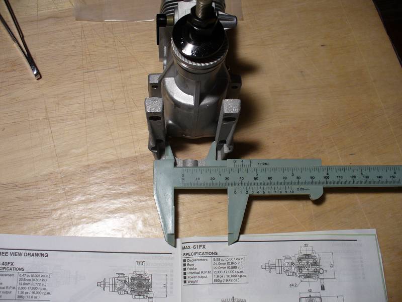

In the picture:
Tower trainer 40 ARF engine mount: ~35.4 mm
Width of OS 61 FX for mount 43 mm
In the ARF version of tower trainer 40 you cannot change the mount, I was looking for something similar with the same bolt pattern but didn’t find.
61 FX will not fit into tower trainer 40 ARF engine mount.
Alex

Old 12-14-2008 | 06:43 AM
opjose's Avatar
Joined: Nov 2005
Posts: 12,624
From: Poolesville, MD
Default RE: 60 size engine on a 40 size trainer
ORIGINAL: alex7403
Not true.
You'll have to plug the existing holes to do it, but you can fit other mounts in there and get the FX .61 in.
I have a friend that has one set up this way.
