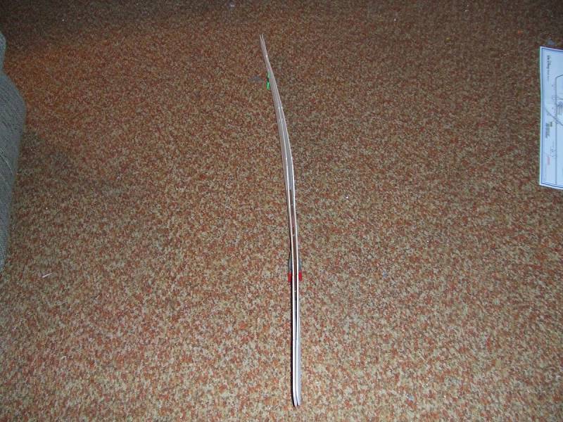

I'm still having a problem with a curved fuselage.
After I glued the fuse doublers to the fuse with titebond I noticed the curve in the fuse sides ( see 1st photo ).
I wet the fuse sides and bent them in the opposite direction for a couple of days and they straightened out.
I aligned the fuse over the plans while building and thought I had it straight.
I'm at the point of fitting the wing to the fuse and took alot of measurements conferming that the fuse is crooked...
I clamped straight edges to the firewall and to the sides of the fuse and took measurements to see how far off.
It looks like the bend is in the wing area.
I'm thinking of making a cut in the fuse side where indicated in the photo.
I think this would allow the nose to go to the left, straightening the fuse and getting the firewall be parellel with the LE of the wing.
I would just double up the ply fuse side when aligned..
Any other ideas?
thanks
Steve

First off, you can't check how straight the fuselage is until you bring the fuselage sides into the top and bottom fuselage pieces. Try bringing all of the parts together and dry assembling the sides to the top and bottom of the fuselage. Use rubber bands to hold it all together down the entire length of the fuselage. This type of fuselage that uses interlocking parts actually count on all of the parts being together to be straight. It's the way it is designed. Taking the measurements like you are you won't be able to tell if it's straight or not. And if you go cutting the sides of the fuse now you will more than likely make things worse.
Ken

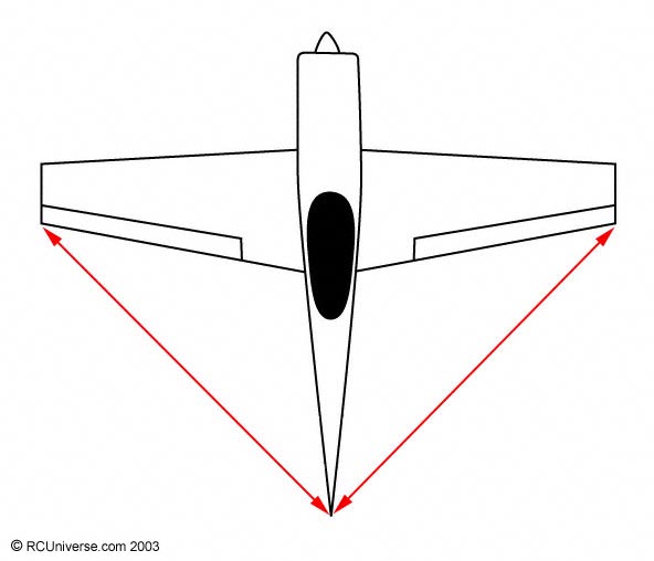

You're not aligning the wing with the fuselage. To do this, you should use a piece of cotton string or a stiff wire. Put a pin into the fuselage at the centerline of the tail. then use that to set the distance to the rear corner of the wing. Adjust the wing as necessary until the distance is the same on both sides. If necessary sand the wing saddle to allow the wing to sit properly when adjsted. If there is some small misalignment between the fuselage sides, you'll not likely notice it when flying the plane.
Do not cut the fuselage.
Brad
Brad
Ken

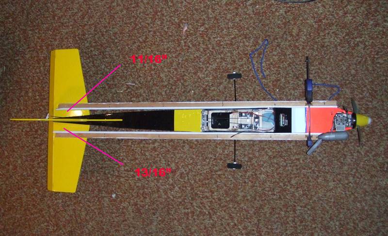

This is a tiger 60 kit.
The fuse is all glued except for the flooring of the cockpit. (plans call for this flooring to install after the following step is done)
I mounted the fuse on the wing to get the position of the TE holes. ( do this by passing a small drill through the already mounted blind nuts through the TE of wing)
As indicated by others, I measure from wingtips to the tail of the fuse. I get a difference of about 3/16" - 1/4".
I could live with this amout??? But as I sight down the fuse I get back to my original problem with the fuse sides haveing a bow in them..
To try and measure any misalignment on the fuse I took some corner moulding stock, which is pretty straight, and 1st clamped it to the fuse sides at the back of the fuse.
These straight edges ran flush along the sides of the fuse up till it got to the wing saddle. the straight edges run on in a straight line. If the front of the fuse was aligned with the tail I sould have equal space measured from each side of the nose out to the straight edges. I repeated this setup with the straight edges clamped to the sides of the fuse in the nose area. (this is the picture I posted) These measurements confirmed the previous measurements. The fuse hase a bow in it.
Clamping a straight edge to the firewall also indicated the same bow direction although I realize some of this angle could be designed for right thrust engine offset??? Seems excessive to me though...
I just tried putting the cockpit flooring in and I dont see that its going to pull anything into alignment. it just fits into place. could be wrong though.
I also tried laying the fuse on top of the plans. It doesnt look to bad using this method of checking!
I've never tried making these measurements on a plane before (clampling straight edges to the fuse sides ) so I dont know if this is unusual? I will try it on my ARF trainer for comparison.
If not for my original problem with the curved fuse sides I might not have even looked at these measurements.
If this is a problem it would be best to resolve it now as opposed to continuing on with the build???
OR, I'm driving myself crazy for no reason?
On the bright side, the wings and tail surfaces are looking good!
Thanks for your inputs...
Steve

I just checked the same measurements on my skyraider trainer and it shows a difference of .125" VS. a measurement of .75" on the Tiger Kit.
Again, indicating a bow in my tiger fuse....
Steve

I don't think I'd trust the way you are measuring.
I think a better way to measure if there is a significant bow would be to make four centerline marks on the fuselage. One line at the firewall, one line in front of the wind saddle, one half way between the wing saddle and tail and one line near the tail. Stretch a piece of string between the front and rear marks and see how far off the string is on the two in the middle.
Go to Ken's post with the picture of how to set up a wing and zero the difference between the wing tips. drill your wing mounting holes and move on. As long as your wing, and tail feathers are set up right it will fly fine.
Also remember, the sides are curved from the nose all the way back to the tail. The widest point is somewhere around the wing. It is thinner before the wing also.
This is model aviation, it ain't rocket science.
