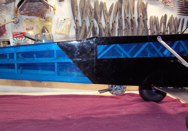

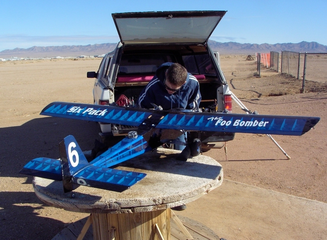

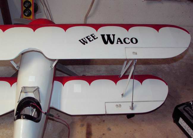

Without a doubt vinyl dry transfers. No spacing hassels with all letters remaining in perfect relationship and really no hassels with fuel proofing if you use a little common sense and not locate anything right next to exhaust outlet. It all done on a computer. I just go to the sign shop with a drawing of the dimensions and the letters just roughed out for spelling and give it to the young man who runs the vinyl machine and tell him to get creative with with the font and to have fun with it and go back a few hours later and they are ready for application. Most of the airplanes costs five bucks and the most I paid is ten.
After doing commercial work all day long he sees my truck pull in and he is out there wanting to see in the truck even before I can park wanting to see 'His' latest airplane.
Adding here a few:

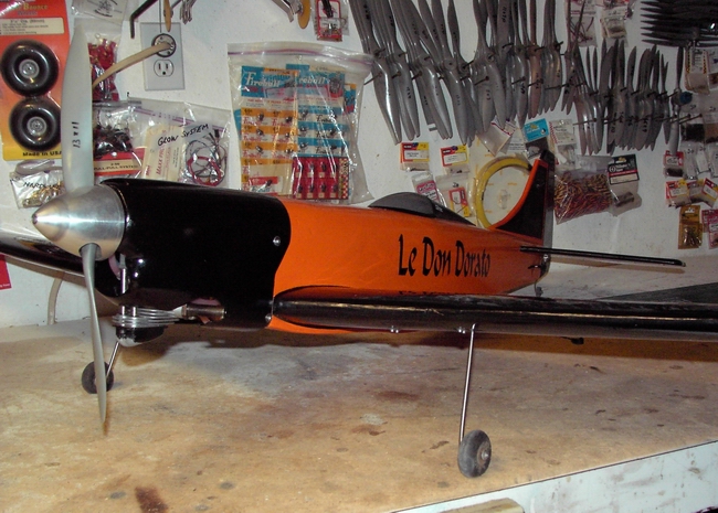

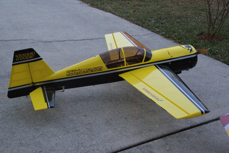

I got tired of dealing with others and bought my own cutter

It wern't cheap but I have a 24" Endura Cut+ from http://www.signwarehouse.com
The + model has the digital motor so it will do curves and small detail work w/o stepping.

john, i love the tail gun on the "foo bomber" very creative

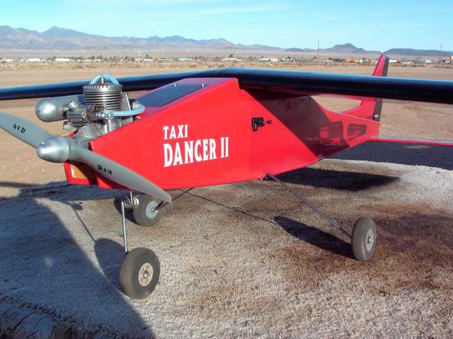

Dry transfer vinyl is very thin usually thinner than ordinary stickers. When it is done it has a backing on both sides. The contact side paper is removed and the letters all remain in the proper position by the backing on the other side. This is used to apply to the surface in the proper position. After it is on mild pressure is appplied to the letters (you can see them through the remaining backing. I normally give them a good rubbing with a desktop eraser, now the remaining backing is peeled off carefully.
This system works very well as far as fuel proofing goes if you use common sense and do not locate them where exhaust puddles up on the airframe. I do not use any kind of over spray, nothing and they have proved to be very durable and far better than ordinary peel and stick designs/letters.

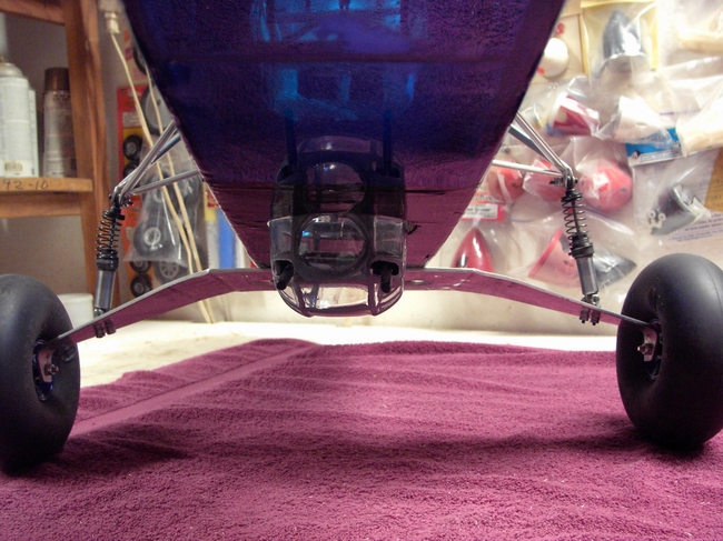

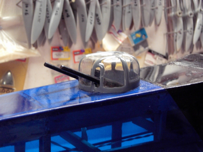

Man, those turrets are super cool!! Good work. What about the shock absorbers? Do they really function, or are the decorative only?

Yes the do carry some of the loads, the airplane weighs 17 pounds and the single piece aluminum strut plate is flattened considerably and will flex quite a bit.
