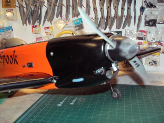

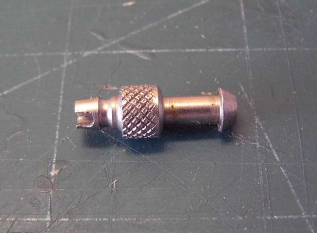

I would recommend just adding a third line and using a fuel dot. They are easy to install, and easy to use. I like the way they look also, kinda like a fuel cap. They are really cheap, and any hobby shop will have a few to choose from.

Here are some pictures of the one I use (cost like 3 bucks at the LHS).

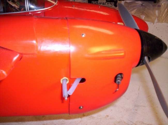

ORIGINAL: chopper man
Is there a good easy way to set up a 2 line refueling system for a cowled engine.
Yes

If you don't have a line and clunck on that third line removing fuel will be a problem. I use dots myself but have tried doing it like John has his, very simple and something even I can't mess up.

If you use that external tubing holder from world models from the previous posts, you can run your fuel feed line through it and use it as a filler and a clunked defueller line.
