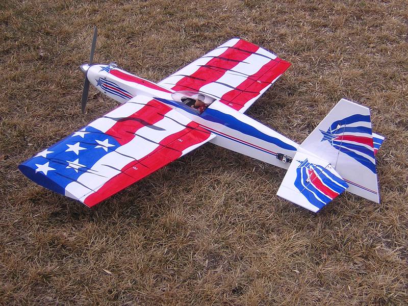

Will that plane do both 3D (not too extreme) and just regular flying, loops, rolls, loops, ect by turning the servo throws down? Looks like a great plane, something i like.

If propped right it should do some 3D. I have a Saito 82 shoehorned in both of my SSE's. Swing a 15X4 prop.

Thats exactly what im looking for, the most 3D i plan to do is hover, waterfalls and just flying slow upside down, i forgot what thats called. Will the OS .55 swing a 15 inch prop?

It should. I have an OS .46 that swings a 14X4 APC.

Somthing extra is perfect but the ARF version is a better flier then the kit, it is much lighter. I owned both. I can do crazy things with my ARF, it has an OS .46. I run a 12x6 prop. Use an apc, they are great. It lands slow, can fly very slow and looks great.
