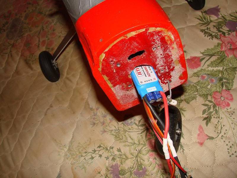

I have this Kadet Mark II that I would like to convert to electric.
I am going to use an AXI2826/12 and Jeti 40plus ESC
As you can see in the last photo the glow engine I had in it is much further out from the firewall than the electric will be. I would like to continue using the cowl if I can, so how can I adjust the electric motor installation so that it is equal to where the glow engine is?
P.S: I would like this solution to be removable in case later I want to convert it back to the glow. -
Stand offs
It appears you do not have far to move it out You could just use a block of wood at least the diameter of the motor mount drilled for the bolts and use long bolts from the hardware store to blind muts in the firewall

At any rate you will have to drill the firewall and install blind nuts for the electric mount and just leave the existing blind nuts in tact.

Can,t help with grafiics. Visulize your motor mount bolted to the firewall as intended but now you used longer bolts throught the mount and firewall and you placed four tubes or a drilled block of wood between the mount and the firewall the thickness of these 'standoffs' is the distance you want to extend the motor forward. The long bolts pass through the motor mount then the tubes or block of wood and finally the firewall.

Here's a picture of the motor mount on my Modeltech Magic. I just kept adding longer bolts and spacers until I got the CG right. The spacers are in a drawer at Ace Hardware.
RCU Forum Manager/Admin
I'm currently reviewing the Electrifly Sopwith Camel and it uses the same method to position the motor. All you need it 3 blind nuts (for behind the firewall), 3 machine screws, 3 flat washers, and 3 pieces of aluminum tubing. Cut the tubing to the length you need to properly position the motor and feed the screws through the mount on the motor. Slip the tubing over each screw and then through a flat washer. Then screw those through the firewall into the blind nuts on the backside of the firewall. It would help to put threadlock on the screws to keep them secure.

You could do it either way, but depending on how far out you need to mount it you might not be able to find nylon spacers that long. The aluminum tube is easier to find, you can cut it to length, and is lighter than the nylon spacers are.

The attached pics is the hole I drilled below the fuel-line opening to pass the ESC through.

I measured the distance and I need 1 1/4" long spacers X I figure about 1/2" diameter. And M3 bolts about 1 1/2" - 1 3/4" long. And my motor mount has 4 mounting holes.
John
Joined: Aug 2007
Posts: 1,610
From: Pittsfield,
MA
ORIGINAL: JohnBuckner
No do not use tubing type standoffs a half inch diameter. Yes of course since your mount is a four bolt type you would use four stand offs but they only need to be of sufficient diameter to allow the bolt pass through. Agine they can be made of almost any rigid type tubing. that your bolts, what maybe #6 will just pass through.
