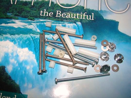

Went out today to get the
nylon spacers - four 1", eight 1/4"
6/32 bolts, washers and blindnuts
and #8 screws
I wanted to be prepared in case I needed the screws instead because of the situation I have.
I can not get into the tank area to set the blindnuts so I have two choices and I need to know which would be more secure.
1) simply screw them into the firewall with the #8 screws or
2) set the blindnuts on the outside of the firewall going in through the front, and us the bolts.

Neither of those is going to be a good situation. The number #8 screws are less than desireable. And if you put the blind nuts on the front of the firewall they will simply pull out. You need to install the blind nuts on the back side of the firewall. It's not difficult to do and there are several different methods for inserting a blind nut into the tank area.
Ken

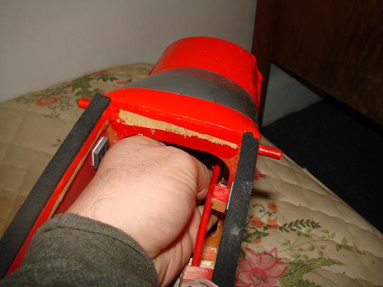

Any ideas how to get into a tank that is fully sheeted?
As you can see in the photos it is a very tight fit.

When I get home tonight I'll make up a diagram on how to do that. It's really not that hard to do.
Ken

I just had to do this on a rebuild of my Four Star. I filed down the tip of a piece of music wire (1/8" maybe) so that I could just force it into the hole on the flat side of the blind nut. Then I held the plane vertically and carefully fished the music wire up throug the fuse. When I got it over the hole, I threaded in a bolt from the front and tightened it down until the blind nut was pulled into the wood. It was an awkward, humorous process, but I got all four of them in without much pain.
I have also seen a method of putting the nut on the end of a wire and fishing it through, but I could not pull the wire hard enough to seat the blind nut into the wood.
I'm looking forward to Ken's suggestion. I'm sure it will make me feel like a dope.

That's exactly one the things I was going to suggest. Another thing you can do is get a long piece of all thread and push it through from the firewall side. Then screw the blind nut on in and pull back to the backside of the firewall.
