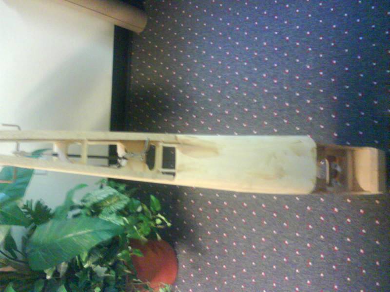

Heres the info and specs on my plane.
Top flight P-51 1/7scale kit.
Wingspan 65"
Length 56.5"
Engine .60-.91 cu 2-stroke
.90-.120 cu 4-stroke
I plans are to look as best as it can. I plan of changing the painting scheme due to visability issues (Charlie P.
) for one and two i dont like it. haha I plan on finding a real paint scheme and transfering it. i may use the one in the Commemerative Air Force Museum.
Anyway, i want the standard flight controls (sorry about not mentioning but i am quite familure with aircraft. im working to get my private pilots license) Pitch, bank, yaw, and throttle. Then i'd like to make flaps as well as retractable gear, both main and tail. And then i'd like to have gear doors on the tail that'll close after they're up. But i dont know what that will entail or the type of skills needed. Right now i have no clue on what parts i will get for what as im doing the research and getting prices for all the parts for the aircraft. nothing else. i know that theres other equipment like field equipment but im just looking to get a price for this plane as it was a $140 kit that i got for free that's already been built.
Now my question is how many servos will i need for this and how many channels will it take? For the flaps i want to use 2 micro servos (one for each) and the retracts will be air powered. And the gear doors (if it is possible wat would they use) (and if its too difficult i wont bother with it.)
Below should be some pictures of the model and what i start out with. Sorry the quality is crap they came off my phone. If you guys want better pictures i'll get some. Any comment, advice, and critizism is welcome.

i have read the book. but my question is i'll need one servo for elevators, alerons, rudder/tail wheel, and engine throttle. (thats 4 servos) then possibly 2 smaller servos for the flaps and one more for the air system. from my plans i stated above is that all the servos needed? (minus the gear doors) and if it is will that use 6 channels?
probably 2 servos for the ailerons, one per. unless the plans use a bellcrank. take a look at some of the build threads for the mustang, there are plenty of them. some have sliding canopies. just remember, you don't want to go too crazy with options on the smaller scale, as it adds plenty of weight, which makes for a poor flier.
http://www.tompierce.net/SBD/html/paint/insignias.htm
this guy put a ton of detail into his SBD, and took home trophies. Read that site for some ideas, but read the whole thing, the ending is interesting, and may help you figure out what detail level to go to.
Not familiar with the kit, but from the skeletal wing image there is a single aileron servo. If you want flaps they'll have to be just the inner variety and will require two servos (one for each side), as you mentioned using micro servos, unless you figure out some kind of torque rod arrangenent to drop the simultaneously from a central servo behind the aileron servo. If using a "Y" connector from a single channel remember to offset them so you don't have beautifullt symetrical servos with one flap coming up and the other going down (a common error). And the only way to fix it once it's built in and covered is to flip the servo arm and then make one control rod longer than the other and forever after you'll bank slightly when the flaps come down.
And don't fall into the trap of thinking R/C has any similarities to full-scale. You don't use your feet in R/C and you NEVER fly at yourself in full scale (when intuition is backwards). The theories are the same but the application is not. (I got through ground school and 15 hours in CAP and college Avaition Club).
I would not bother with a retractable tail wheel with doors on a 65" model. They gave them up as too heavy and problematic for the minimal returns on the full scale Spitfire. You do not need added weight in the tail of a P-51 unless you want it to fly like a Brewster Buffalo ("stodgy").
Sage words.
Take a look at what I've wasted months on for a ARF with no retracts and only the routine four control groups. Redundant battery & switching for the receiver, electronic ignition for the (gasoline & sparkplug) engine, isolated kill switch with fiber-optic actuator (so it won't have inductive interference to the receiver through the the component wiring). Madness.
If you try to do too much . . . . You'll never get it finished
