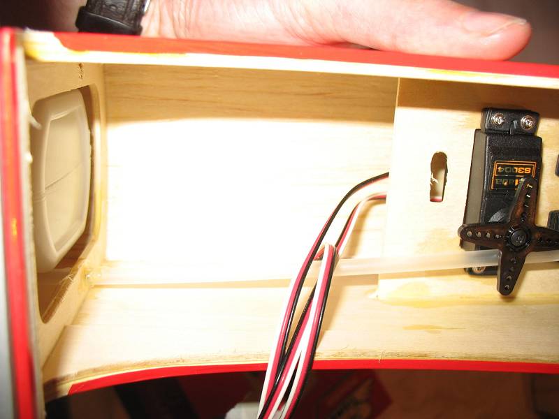

OK TedMo: First two are of the rear portion where I want to put it. It is hard to access. It needs to be far enough back not to interfere with the aileron torque rods.
Last out is the front bay which has tons of space...

Maybe mount your battery securely on a dowel or stick then slide it down the fuse to a point where it balances good then screw the stick down to the servo tray? I've also pulled covering off from lightening holes in the fuse and made battery mounts inside.

I am worried about the battery bouncing around in the rear section and was thinking how to fit a "platform" given there is effectively no access....but I suppose I could wrap a TON of foam (floor to ceiling) which would just wedge the sucker in there....
The only problem is the access hole size is smaller than the floor to ceiling height but I might be able to pack it in and around after inserting the battery. Worth a try.
Thanks. I knew to wrap in a little foam for vibration but never extended that to wrapping to prevent movement. I can use packaging foam.

I'm sure that was just a typo, but anyway chemie I wedged my battery pack in the back of my extra with a bug chunk of seat cushion foam rubberbanded around it. It works fine. Give it a good shaking to see if it will hold, you don't want it coming loose and unplugging on a rough landing.[sm=thumbup.gif]
