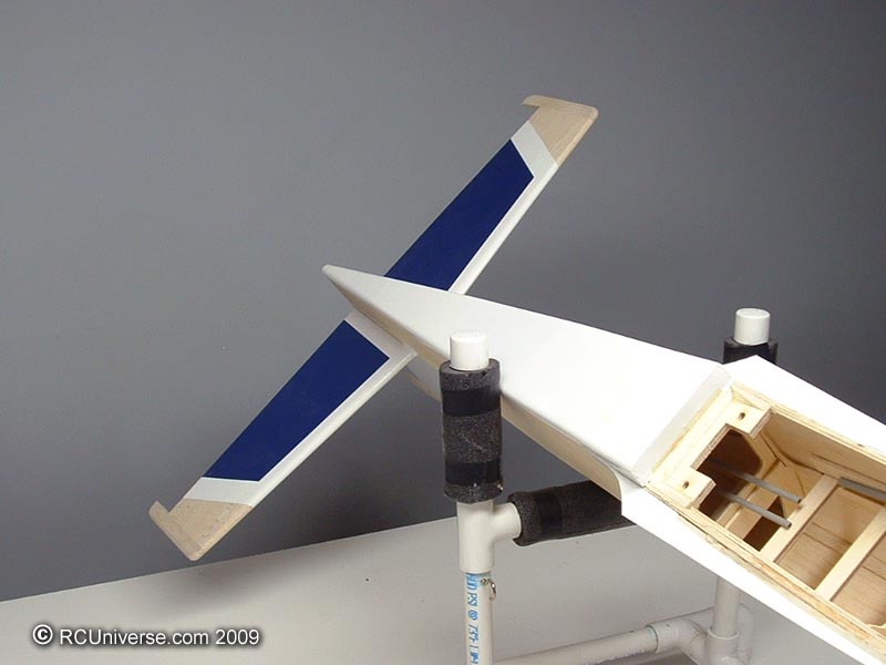

ORIGINAL: _Chuck_
I am by no means a covering pro. But one thing I want to emphasize.... new sharp blades. Minn sings the praises of them in his video. I just want to echo it.
Yup. In fact, I'm covering a plane now. All that's done is the tail (Most of it anyway) and the wing fillets, and I've already gone through 3 blades.
ID:	1113594   Click image for larger version

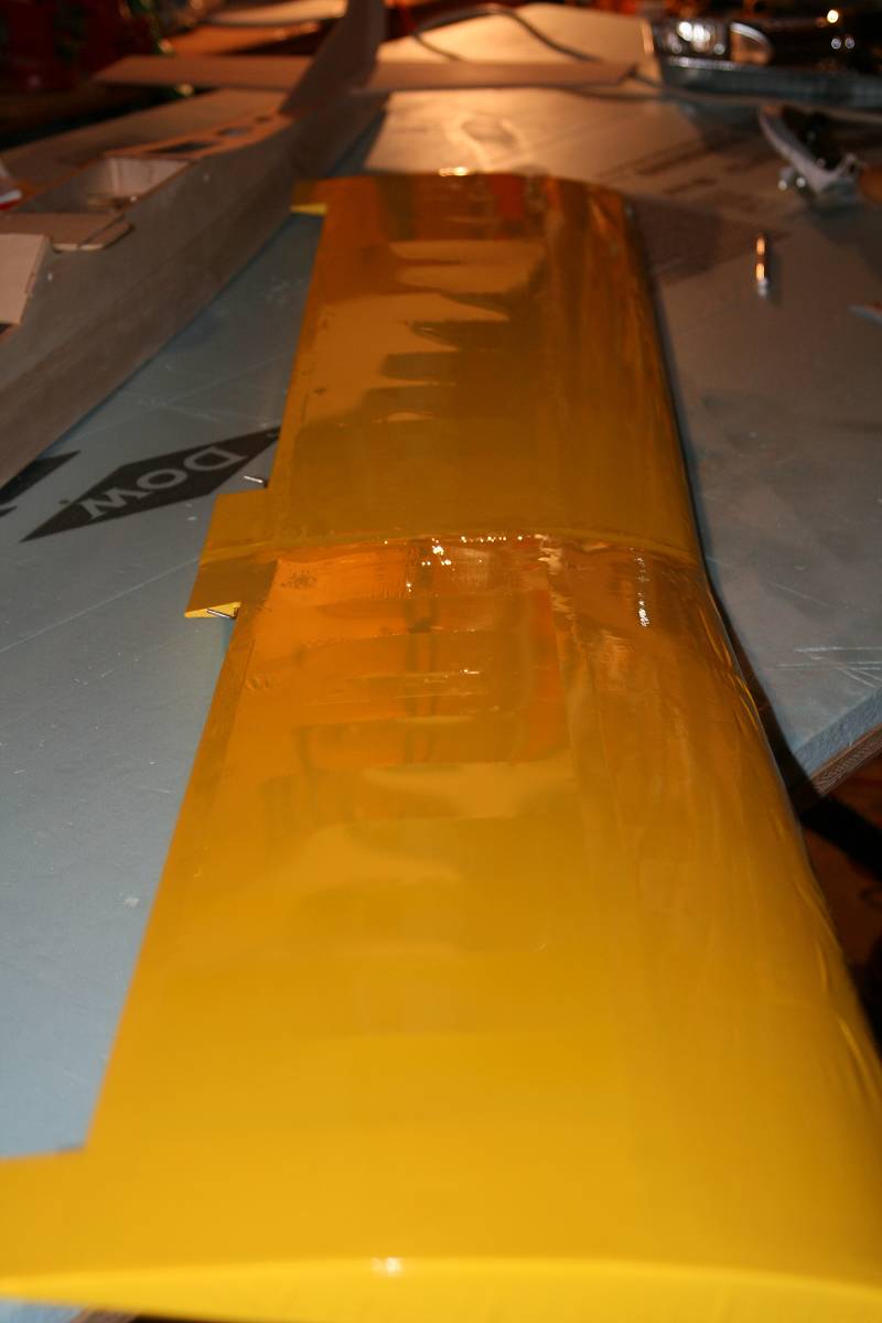

Old 01-18-2009 | 10:05 PM
jmwright75's Avatar
Joined: Dec 2008
Posts: 185
From: Glasgow, MT
Default RE: First Time Covering
The pic of the wing tip is hard to see but there are wrinkles in it. I plan on doing orange and red stripes and some orange stars.
john
ID:	1114006   Click image for larger version

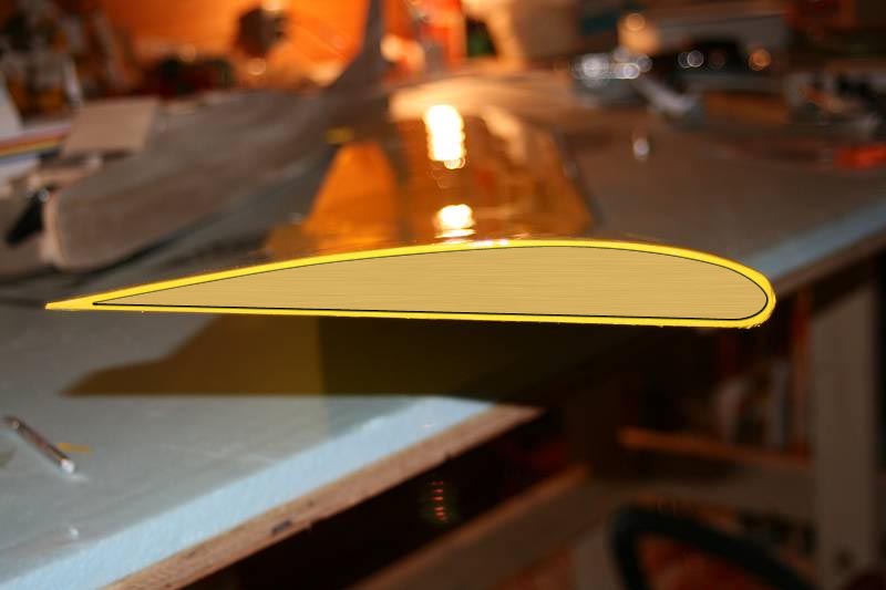

Old 01-18-2009 | 10:32 PM
MinnFlyer's Avatar
Posts: 28,519
Received 9 Likes on 9 Posts
From: Willmar, MN
Looks great for a first try.
What I would do now is to cut off the piece covering the wing tip and just add a new piece just covering the end.
Old 01-18-2009 | 10:33 PM
MinnFlyer's Avatar
Posts: 28,519
From: Willmar, MN
And yes, Ultracote is much easier to use. If that were Ultracote, you'd be able to iron those wrinkles out
